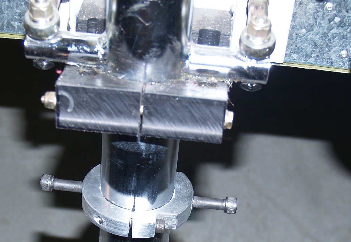

I found one more picture that is important if you plan
to go this route. The countersink for the back holes
get into the stop-block part of the bearing. This may
be difficult to do on a drill press - I used my little
mill.
