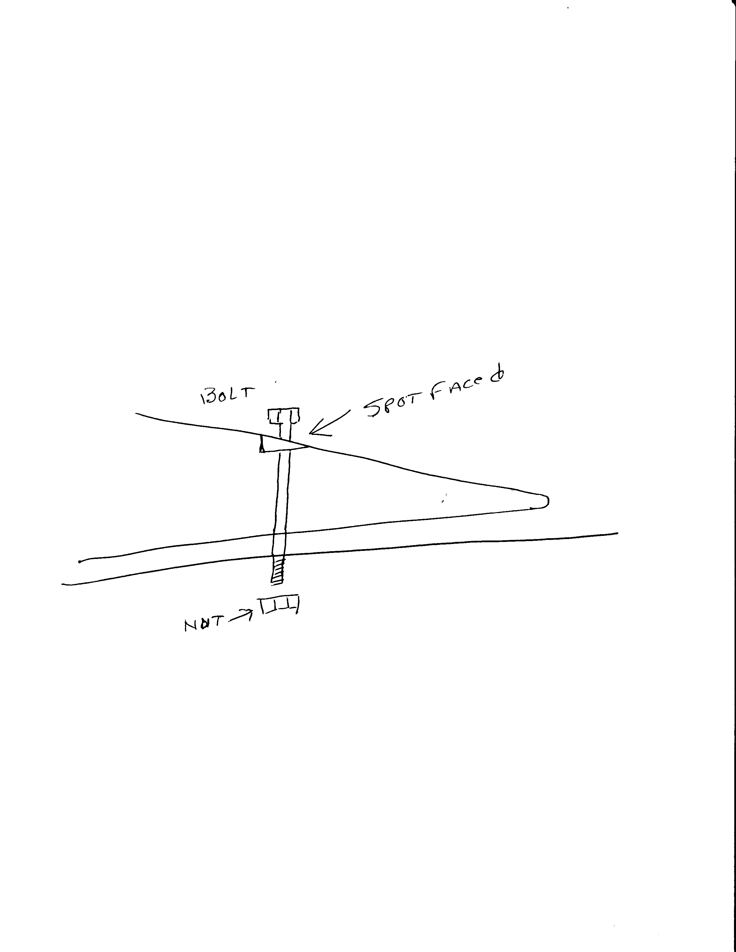

rstone4(at)hot.rr.com Guest
Posted: Tue Jul 25, 2006 12:02 pm Post subject: Big holes |
The tool you guys are talking about is called a "Spot Facer" it is used to provide a flat surface just a little larger than the bolt or screw head when the part being fastened has a surface that is not at the same angle as the part it is being fastened to. I have attached a drawing to help show what I am talking about. If you are going to get one or a set of these remember the reason for the spot facing around the hole is not only so the bolt head will fit flat on the surface but so you can also get a socket on the bolt head when you are trying to tighten a nut on the other end.
Bob Stone, Harker Heights, Tx
Zodiac XL (Not too far along)
