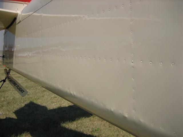

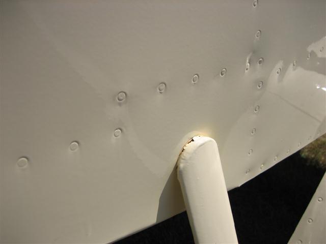

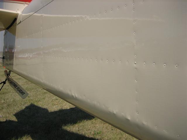

Re. the quality issue, There is no one or two specific things, that you
can point to, but the quality of the workmanship is easily apparent to
any builder. Seams that don't match, wrinkled metal, pop rivets holding
windows to their frames, surfaces not prepared, sanded smooth/filled
before painting.finishing. Wings skins not 'scarfed' per the plans,
these are just a few that come to mind quickly. When looking at these
planes, they scream that they were put together with speed to completion
as the primary goal, pride of workmanship obviously took a holiday, and
one immediately begins to ask oneself, " If these readily visible
shortcuts were taken, what shortcuts that aren't so apparent were also

Deems says it well here. There is no ONE thing. There's such a
variety. Most of the time, we're not talking cosmetics, although
doing a really shoddy job cosmetically never wins you points.
Most of the things that get pointed out negatively are things
where someone obviously was in a hurry, or really showed a lack
of care...not just the occasional newbie bucking bar ding. If a
builder just builds to plans, and uses all the acceptable
practices for things, they have nothing to fear. People like
Ray Doerr show up without any paint at all, rivet lines scuffed
and ready. Nobody criticizes him because his workmanship is
good, and he took care on his project. The care thing really
shows on fiberglass parts, when you obviously don't sand things
well, or don't trim wingtips and make them match the trailing
edge. On aluminum, it'll be things like not deburring things,
consistently denting your skins along rivet lines, or not
seating rivets by not dimpling skins enough...sometimes cosmetic,
and sometimes structural issues. For electrical, at OSH 2005
for example, I saw an entire bundle of wires snaked down through
the forward slot in the tunnel cover, laying snugly against
the sharp metal edge of the tunnel cover....which by other
indications on the airframe was probably not deburred much
or at all. It's a recipe for disaster, and doesn't follow
any acceptable practice. As Deems says, it's stuff that any
builder who thinks about, and puts care into building, would
notice.

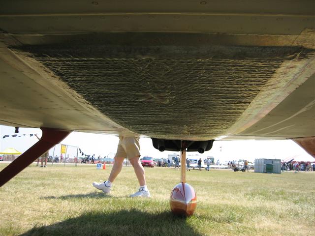

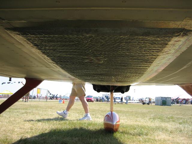

Let me just put some pictures to these statements. Some items are
bubble wrap for a heat shield, beat to hell skins, some finish work that
would make an amateur blush, rusted door hinges, paint bubbling from
rust on steps, screws falling out and fairings improperly fitted and
falling off. Of course pictures don't show the detail but you get the
idea.
Michael

PostPosted: Mon Jul 31, 2006 11:20 am    Post subject: RV-10 Quality @ OSH -w/ appoligies to John Cox Reply with quote
Tough one. Might be better to leave the skins open but you will hate
going back to it later. Pretty mindless riveting in the wings.
Something I want to say about the bubble wrap and HVAC tape comment I
had, in reading some of the 500 or so emails I had waiting for me today
(I did go straight for this list though) I also found that the bubble
wrap and tape is only temporary to test the theory of insulating. The
owner plans to replace it with a SS heat shield. Doesn't make up for
the rest of the quality but to each his own. One of the things John
Forsling is going to do to my pipes is add a 30 degree or so downturn
right at the end. This should make a good dent in noise and heat.
With all this talk about quality I can say nothing stood out that
screams fall out of the sky. Structurally speaking I think all of the
aircraft were probably sound even if they were fugly. Very Happy At least I
hope so or we are going to be facing a insurance crisis on par with the
Lancairs in the past.
Michael
