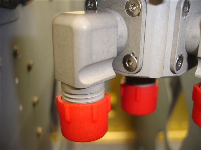

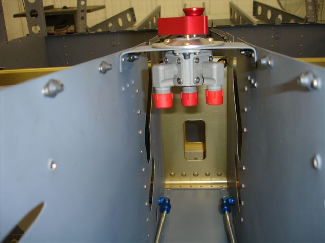

At Oshkosh, I ordered the new Andair valve (FS20X7) (http://www.andair.co.uk/system/index.html) for my RV10. When I got home, I read Tim Olson's site and the problems he had with clearance with the male AN fittings. So, I sent an email to Andy and told him of the clearance problem on the RV10 with that valve.
I was expecting him to send me a valve with female ends on it so that I could put my own 90 degree el's on it. Instead, he sent me this. Check out the pics below.
Zack

Zack, the photos didn't come through. You may want to try again
or I can post photos if nothing else works. Just to clarify
though, the FS20X7 I don't think was the part I used...if I
remember right. I think that was the new Y oriented valve,
right?
Good luck, you'll like the Andair valves.
Tim

Ooops, I didn't see the attachment links. Yeah, those new
90 degree fittings were just coming out but AFTER I got my
valve. Those are definitely much nicer than what I had to
deal with. I don't know how much more space you get on the
180 degree valve, but on that valve, it would be fantastic.
You're on the right track for sure.
