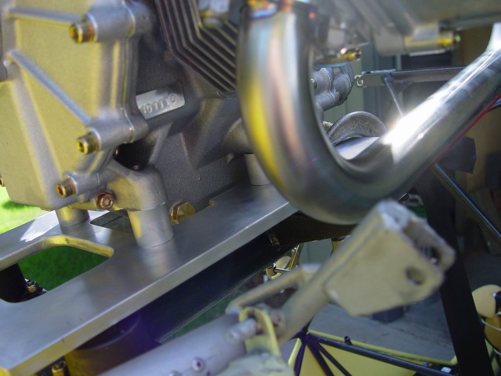

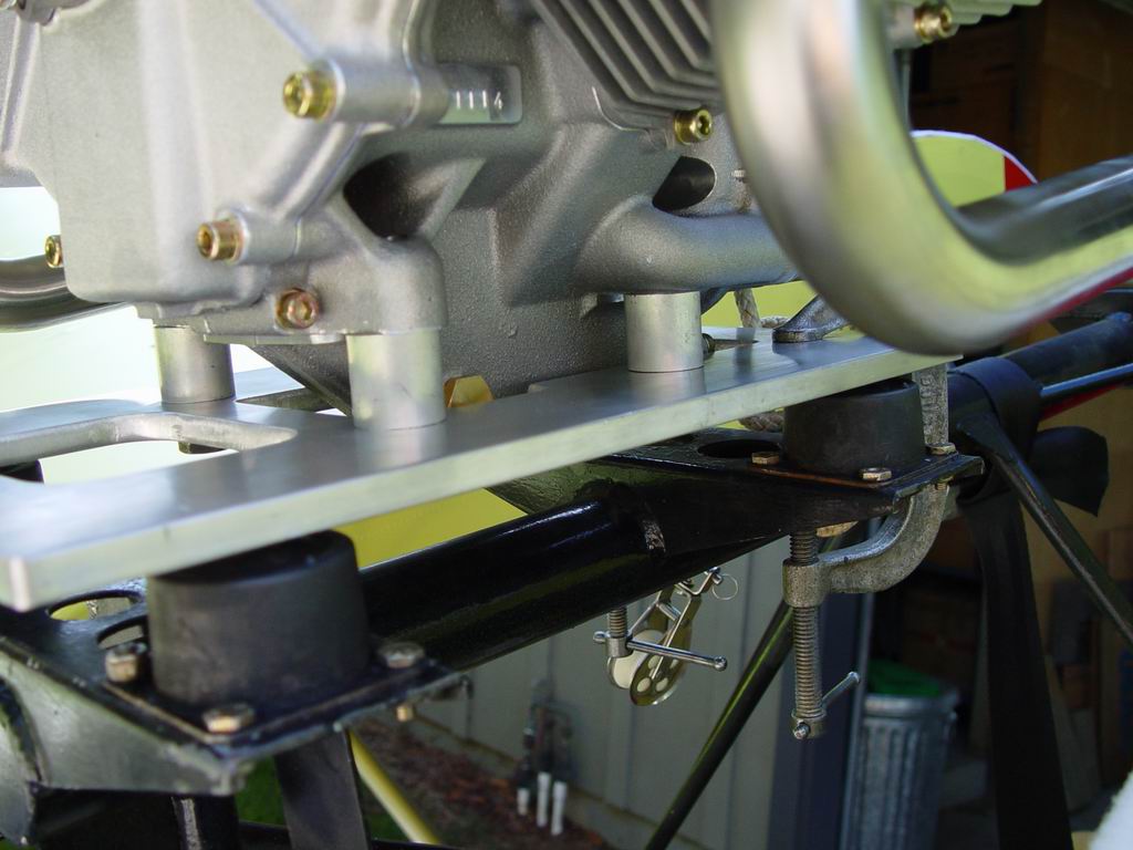

PostPosted: Sun Nov 12, 2006 7:03 pm    Post subject: Re: Firestar II HKS Conversion Reply with quote
I have the HKS mounted on the Firestar, and am working on hooking things up. The ignition modules and coils are mounted on the aircraft frame (not on the engine). There is also an oil tank and oil radiator to mount.
The engine is beautifully engineered and looks right sitting there on the Firestar. The final gearbox will be the 2.58:1 B Box mounted down. The A Box (mounted up) in the pictures will be replaced. The thrust line is too high with that setup. I plan on using the same 66 inch two blade Powerfin prop that I used with the Rotax 503. Looks like the fuselage boom clearance will be about one inch.
The engine had to be mounted forward enough so the exhaust manifold pipes clear the aileron torque tubes and control horn when folding and unfolding the wings. This will require a prop spacer to give adequate prop clearance from the aileron torque tubes when flying.
Jerry Olenik from Green Sky Adventures has been working closely with me throughout this project. He plans on offering a mounting kit for the Firestar after we finalize the installation and do the test flights.
I'm hoping to test fly it shortly after the first of the year.
Clearance between Exhaust and Aileron control horn and torque tube is very tight.
 Filesize:  77.56 KB
 Viewed:  1037 Time(s)
Tempory mount clamped on while checking wing fold.
 Filesize:  87.24 KB
 Viewed:  1053 Time(s)
Dave Bigelow
Kamuela, Hawaii
FS2, HKS 700E
