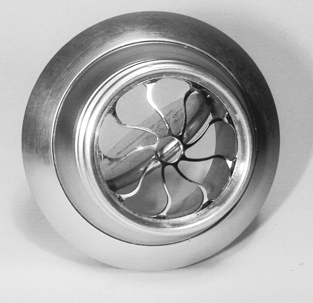

Vic tipped me off at OSH that the large aluminum eyeball vents
provide much more air and leak less than the cheap plastic ones.
I originally used the $17ea Van's black plastic vents. They worked
OK. They didn't stay open when you wanted them open, and they didn't
close as tightly. Adjusting the flow was tough at best. The flow
seemed OK.
This weekend I put on the aluminum vents, VENT SV-6 BLACK from
Vans. $145ea. These work very nicely, provide more air, far better
air control, and a better seal. Surprising, but they were worth it,
especially in the summer. The deal was sold for me to buy them when
on a high-speed descent last week, you could hear the sound of
air rushing in, and all of a sudden my vent popped shut. The
sudden noise change startled me for a millisecond. It was then that
I decided to invest in better vents.

I second Tim's recommendation. I got mine from Affordable Panels for
$117.50 each plus $8.45 shipping. I got the black ones and painted the
screws black and they look and work great.

I third this nomination. The cheap ones are terrible. They don't stay
where you put them, and when it is cold outside, you really want it to seal,
which the cheap ones don't. We got the black ones and they are part plastic
and part aluminum, but they seal great and work great. This is definitely
worth the investment.

Yes, the metal vents are much better. If you look around, sometimes you can
find the metal vents "like new" for a lot less. I paid $20 each for the
vents on my first plane. I found some for the RV10 that were $40 each in new
condition.

This is true. For quite awhile I drained many of the the salvage houses of
all their vents for half of new (I've gone through literally hundreds of
them over the past couple years). That being said, the quality of used ones
and quantity just has just started to run out as other people (like Kevin)
encroached on my supply Smile
So....I spent many months doing reasearch with all my old airline buddies
and found the supplier that makes the Vents for the military and
Boeing/Airbus which are a LOT cheaper than what is out there currently.
They are literally mil spec vents that I now have for sale on my site in
both Black and Clear Anodized Aluminum at $90 or $100. They are quite
superior in construction to the other ones out there in the large size, and
instead of a large square mounting plate you simply cut a hole (either 2" or
2.75" and screw on the plenum from the back). The small ones work
beautifully as well as the larger ones (I have the smaller ones in my RV and
they work great). I know they won't work too well as a retrofit for the 4
hole flange mounting pattern, but if you haven't done that yet don't waste
the space! These vents also include the mounting plenums as well. The
larger ones I have only take a 2.75" hole instead of a nearly 4" square hole
pattern for the flanges which are currently offered from Van's.
Sorry for the plug....but there is another option out there and unlike the
AirKit/Van's/Affordable Vents which are all copies of each other I don't
know of anyone else selling the vents I found other than Boeing and a few
defense contractors.
Cheers,
Stein.

The vents Stein has are probably the best available, but none that
he has *today* are a drop-in replacement that works with the
4-hole thing sent with the kit. What he's saying is if you want
a better, cheaper valve, do a little creative engineering and
don't attach that 4-hole thing, but attach a hose, mount the
valve differently, and use his valve.
Jesse was right that the doors are one of the weak design areas
of the plane, but the ventilation is another. I'm all for
trying to figure out something better for the front vents, but
in the end I gave up. The newer kits with the lower cutouts
may have better luck.
At any rate, the 4-hole ones are what I used, so I couldn't
get them from him right now. I believe he may be able to get
them eventually, but I'm not sure. After seeing the ones on
his site, I wanted to go down that path, but just couldn't do
it today. Stein, work on those guys to get you a supply and
you'll sell a bunch.

aircarepros(at)yahoo.com
PostPosted: Wed Aug 16, 2006 6:18 am    Post subject: Air Vent Recommendation Reply with quote
[quote]Date: Wed, 16 Aug 2006 07:03:21 -0700 (PDT)
From: "John N. Strain II" <aircarepros(at)yahoo.com>
Subject: Re: Air Vent Recommendation
I am attatching a photo of even another option for vents. These vents are the most highly styled available and provide more air movement than any of the others that have been mentioned. They were displayed in the Flightline AC booth as an upgrade option to our ac systems. They mount thru a skin (overhead or panel) by drilling a 2.5" hole and are held in place by a threaded fitting that can accept a 2.5" hose, or they are trimmed to allow for use in an overhead panel. They fully close off, partially open, and fully open via a telescoping mechanism and rotate 360' to be able to focus air movement. They are a machined aluminum part. They sell for
 Filesize:  167.35 KB
 Viewed:  364 Time(s)
stein(at)steinair.com
PostPosted: Wed Aug 16, 2006 8:45 am    Post subject: Air Vent Recommendation Reply with quote
Well....both types of vents will work. It just depends on what you do with those "dumbo/elephant ears" on the lower corners of the panel. The standard Van's vents use a pretty large flange with 4 screw holes in them. The vents I chose to procure do not have the flange on them and as a result the size of that ear can be nearly 1" smaller overall than the flanged ones. We looked at getting those, but I figured as replacements we wouldn't sell many because people probably already had the higher buck aluminum ones from Van's, and new builders would like the smaller area required by the "flangeless" vents. While they still have a flange on them it's only about 1/8" around the circumferance and the vent is held in place by screwing on the plenum from the back. At least that's what I prefer, and so that's what we ended up with! I've been flying behind the smaller ones for years in my -6 and they work great, but the larger ones will inevitably allow for more airflow.
If there's any lesson to be learned out of this it's to file those worthless plastic ones in the garbage the minute you get them (us old little RV builders learned that lesson long ago) - but that's just my opinion!
Cheers,
Stein.
do not archive.

Tdawson(at)avidyne.com
PostPosted: Wed Aug 16, 2006 11:41 am    Post subject: Air Vent Recommendation Reply with quote
Looks like the vent from an old Camaro.
Your post got truncated at the most important part – the price! Don’t leave us in suspense!
TDT
PostPosted: Wed Aug 16, 2006 11:46 am    Post subject: Air Vent Recommendation Reply with quote
So, Stein, you need about 2 inches of panel space for the 1.25” vent and 3 inches of space for the 2” vent?
TDT
40025
PostPosted: Wed Aug 16, 2006 3:03 pm    Post subject: Air Vent Recommendation Reply with quote
$125.00 each
PostPosted: Wed Aug 16, 2006 3:27 pm    Post subject: Air Vent Recommendation Reply with quote
You are correct. The small ones need a hole (OD) or 2", the large ones need a hole (OD) of 2.8" or nearly 3".
