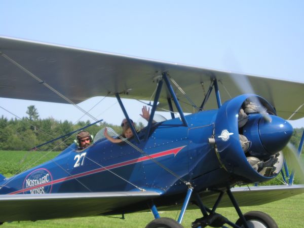

We too had a new experience this past weekend. We went to 3 local
fly-in's in the RV-10, one of which was at a small grass strip
with just about every type of small plane and ultralight you can
imagine. We paid and took the 4 of us up in a 1929 Curtis Wright
TravelAir Biplane. It sure was an experience! I've never
seen my youngest so happy in an airplane. (photo attached)

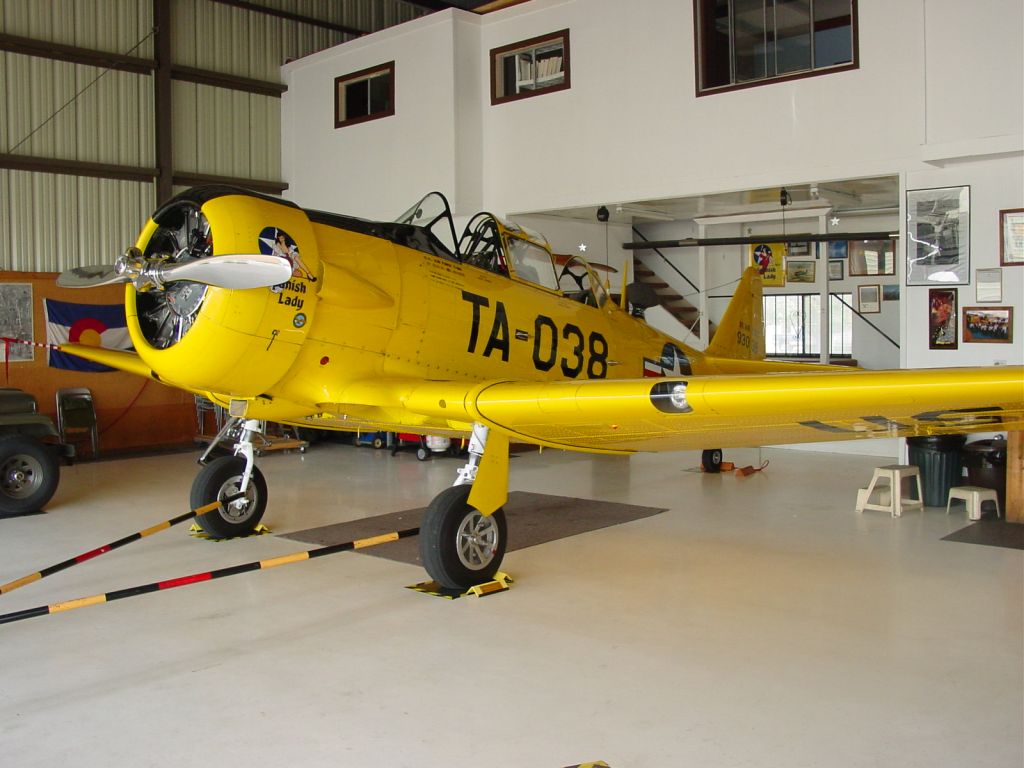

I've attached a picture of the AT-6. The pilot/owner is Dick Jones. The
plane is "The Spanish Lady" and it is beautiful on the ground and in the
air. Unfortunately, he must sell it due to high fuel costs. Anyone want to
upgrade?

Dick is a fine gentleman and I too did some aerobatics with him and
Spanish Lady back in 1990 when I was producing airshows for the Blues.
He was based at Centennial (Colorado) and the memory of our low pass
over Chatsworth Reservoir at 50' AGL was unforgettable.
This is a well maintained T-6 if there are other Warbird fans within the
RV-10 community.
