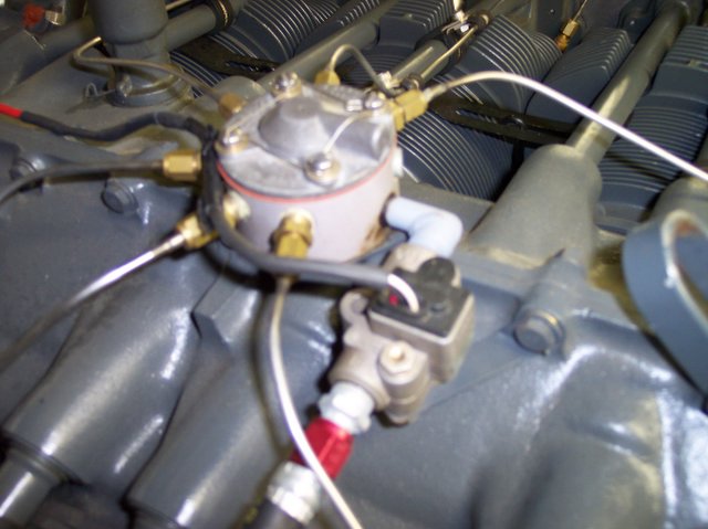

rocketbob(at)gmail.com
PostPosted: Thu Aug 17, 2006 5:15 am    Post subject: Looking for AN816-4-6D Reply with quote
Gerry, the best way to deal with this IMO is to make a 90 deg. fitting by welding a 1/8" NPT pipe nipple to a 1/4" NPT pipe nipple as shown in the attached image. I occasionally fly this F1, it has the AFS system and the fuel flow readings are rock-solid. The flow transducer was moved here from a different location in the center tunnel near the boost pump. The flow transducer did not work well near the boost pump. Note that a small bracket was made to support the flowscan transducer.
[img]file:///C:/DOCUME%7E1/BobJ/LOCALS%7E1/Temp/moz-screenshot.jpg[/img][img]file:///C:/DOCUME%7E1/BobJ/LOCALS%7E1/Temp/moz-screenshot-1.jpg[/img][img]file:///C:/DOCUME%7E1/BobJ/LOCALS%7E1/Temp/moz-screenshot-2.jpg[/img] [img]file:///C:/DOCUME%7E1/BobJ/LOCALS%7E1/Temp/moz-screenshot-3.jpg[/img][img]file:///C:/DOCUME%7E1/BobJ/LOCALS%7E1/Temp/moz-screenshot-4.jpg[/img][img]file:///C:/DOCUME%7E1/BobJ/LOCALS%7E1/Temp/moz-screenshot-5.jpg[/img] Regards,
Bob Japundza
RV-6 flying F1 under const.
