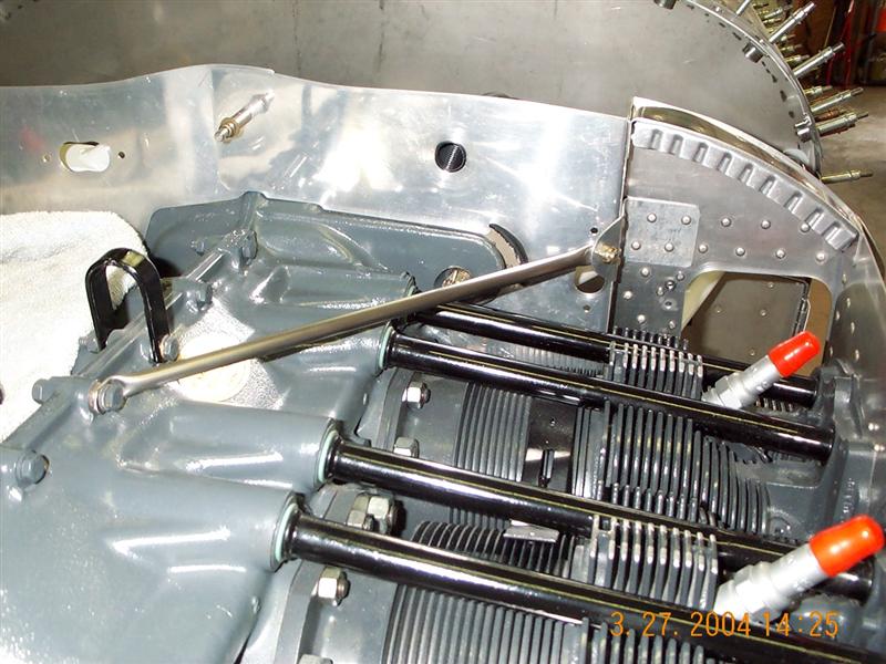

See attached. I got the tube reinforcement from Dan C. Knock on wood,
holding up well so far...
Larry Bowen

Thanks for all the info and pictures I am grateful for having a great tool
with this group and getting all this info .
It seems that it makes sense to mount it on the baffles as far as cooling
and it can be reinforced so it can be more durable.
