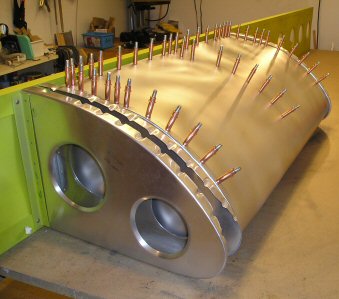

				Phil, where exactly do these rivest go?
 Got a diagram or photo?
 Feel fre to email me directly.
 Carlos

  I neglected to mention that I am building a 601HD
  I have L section .025"   spar cap and spar cap doubler .125 each and spar
  web .040 as per drawing 6V4    all of which amounts to more than an A5 can
  handle.
  regards phil Plumley  G-ZENI

  >Are you sure? I see the L angle material as .025" and spar material as
  >.050" for a total of .075" and the A5 grip length as .312" so they should
  >be plenty long. One of us apparently is confused or missing something.
  >OOPS, I'm assuming 601XL, but perhaps you are doing a different model.
  >    Robin, Jasper, AR
  >    N601ZV

				Phil, that would be a *solid* rivet. Not very clear, as the drawing says "A5", but I did use
 solid rivets on those  "L" angles.
 If the attached file makes is to the list, you can see it.
 Carlos
 CH601-HD, plans
 Montreal, Canada
  > spar web .040 as per drawing 6V4    all of which amounts to more than an
  > A5 can handle.
  If you look at the detail at bottom center of drawing 6V3, it shows the
  spar being riveted together with solid rivets. I'm not sure, but might
  this also apply to these nose rib L sections?
  RonB
