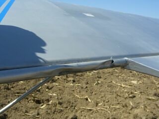

Well, there's a Warp Drive prop somewhere West of Chowchilla, CA... I think it ended up in a corn field... Prop shaft (belt drive) broke forward of the hub and the hub and prop departed my 503 Firestar at about 1000' taking the right aileron spar/torque tube with it... I landed in a disced field and thanx to my big tires, no landing damage... Second no power emergency landing in the first 11.6 hours I've put on the Firestar... Prior to that, I had no dead stick landings in over 4600 GA hours... I really like the concept and the way the Firestar flies, but I'll probably go back to a store bought plane...
David
On 9/2/06, planecrazzzy <planecrazzzy(at)yahoo.com (planecrazzzy(at)yahoo.com)> wrote: | Quote: | --> Kolb-List message posted by: "planecrazzzy" <planecrazzzy(at)yahoo.com (planecrazzzy(at)yahoo.com)>

Question: Were you using a two blade or a three blade? I have been
warned about using a two blade on mine.

Two blade... And remember this is a belt drive, not a gearbox...
DVD

Which belt redrive was it? I'd suspect the redrive, and switch to the proper gearbox. Haven't heard of any GB's letting the prop depart the aircraft.
Ed in JXN

David.Lehman
Joined: 10 Jan 2006 Posts: 265 Location: "Lovely" Fresno CA
Posted: Mon Sep 04, 2006 5:17 am Post subject: Re: Need new Prop |
[quote="Ed in JXN"]Hi David,
Ed in JXN
MkII/503
Hi Ed...
I don't know the manufacturer of the belt drive...
I think this Kolb is/was an excellent example of "you get what you pay for"...
If it ever flies again, it will be with a gearbox, or direct drive, no more belt drives for me...
DVD
