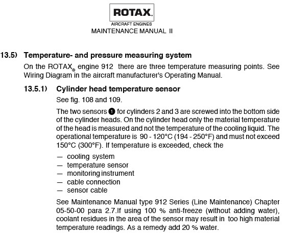

the max of 140C so I would not be too concerned about that. There is no
normal range specified for the CHT and you kept it below the 150C max.
Again no real concern. Oil pressure was maintained in normal range. No

Thom Riddle
Posts: 1597
PostPosted: Mon Sep 04, 2006 6:11 am    Post subject: Re: Allegro 2000, 912UL Initial Engine Test Run Reply with quote
Giles,
I have reviewed, again, my Operator's Manual, Installation Manual, Line Maintenance Manual, Heavy Maintenance Manual and all Service
Documentation available at Rotax-owner.com since July 1998 (date of my Operator's Manual). The only place I found what could be interpreted as a "normal cylinder head temperature range" is in the Heavy Maintenance Manual. See attached image. All the other documentation I've looked at contain only a Maximum CHT specification. You will notice that it says the "operational temperature" is 90-120C (194-250F) with a MUST NOT EXCEED CHT of 150C (300F). It also says what to do if the maximum is exceeded. In Hugh's case, he did not exceed the maximum. I don't think Hugh should be at all concerned about having run his engine at 130C CHT.
I'm not trying to be argumentative, just wanting the facts to be known. This is the best information I've been able to find on the subject. If you know of another more up-to-date source from Rotax, please let us all know.

Gilles.Thesee(at)ac-greno
PostPosted: Mon Sep 04, 2006 7:38 am    Post subject: Allegro 2000, 912UL Initial Engine Test Run Reply with quote
Hi Thom,
Documentation available at *Rotax-owner.com* since July 1998 (date of
head temperature range" is in the *Heavy Maintenance Manual.* See
Operator's manual Rev 3, July 2004 page 10-1, states the limitations
and best operating ranges.
An updated version of the various manuals can be downoaded from the
Kodiak research website : http://www.kodiakbs.com/tiintro.htm
The Rotax-owner's website provides the list of effective documentation
for the 912 :
http://www.rotax-owner.com/SI_TB_INFO/returndoc.asp?PATH=http://www.rotax-owner.com/si_tb_info/serviceb/sb-all-000-r4.pdf&DOCID=SB-912-000&S_TYPE=SS
