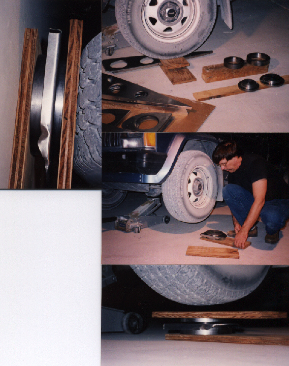

There are all kinds of ways to press. Did you hear about the guy who used his car. He put the flanging die under one of the front wheels and jacked the car up and down with an air driven bumper jack. All it takes is a good imagination. And the will to stick with it until you are flying an airplane you built and there is nothing like it.

This is very "old Hat" for nearly everyone on the list, but I couldn't resist the opening, especially now that pics can be attached. Note the dies are not made of plywood!
This system worked great. I still can't emphasize enough, before flanging, sand the inside of the hole until you can run your finger around it and feel that it is perfectly smooth. Anything less and the flange will probably crack. I was in such a big hurry to try my dies that I failed to do this and wound up with two cracks in a nose rib flange. Had to make another nose rib because of this, another lesson.
Randy L. Thwing, Las Vegas, do not archive

Randy, I love your 1 ton press. Now that's thinking laterally! Jamie Hyneman would be proud Wink
