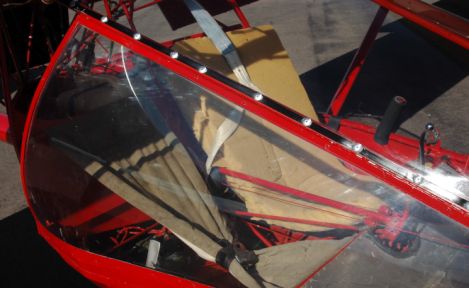

While waiting out an effort by an A&P to repair flap lever this afternoon, saw a spray can of Plexus on a shelf in his hangar. He didn't know if it was any good...got it with a C-150 he bought.
I used it on the MkIII, sprayed on, wiped off, buffed with a clean t-shirt, and it worked better than anything I have tried. Haven't found Novus Plastic cleaner& shine, Micromesh, 3M plastic polish,C-CICE, V&PM Naptha, or Harley Davidson Cleaner/Polish; all recommended to me by you helpful folks out there, in this small NM town.
The difference in the Plexus-treated window at top and the untreated "DeLorean" right door is amazing.
Now to find the stuff! No, I don't work for them. Now if I can't get the flap lever repaired, will get to see if I can see in early morning sun.
jsf
