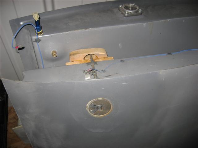

PostPosted: Tue Sep 12, 2006 6:41 am    Post subject: Kitfox and Fuel Starvation Reply with quote
Here is what I did and I think it is easier that Dons method for a retro fit.
After having the parts in hand it just cut a hole the size to fit
but left enough tank so the flange fit on top of the tank. This
method leave some of the old flange imbedded in the tank top. Then I
chamfered the mounting holes and made very rough gouges on the back
of the flange so when I bonded the unit to the tank it would have
lots of grip. Some shaping of the flange was required to make it fit
flush with the tank. I did not use screws to clamp the flange, but
you may want to? If so remember that each screw is a possible leak path.
Then I drilled a hole in the tank end and ran my 1/4" vent to a
location near the filler - then down. I used safety wire to hold the
vent pipe to the top of the tank. The safety wire was brought up so
as to be under the flange for good electrical contact. The lump of
twisted wire make contact with the flange for the ground. Then I used
a clamp to the vent line to allow a wire to go to the spar. I even
drilled small holed in the side of this new vent to allow a higher
gas level. Read Dons comment of venting at the wing tip for a better
method. My vent terminated directly straight down.
Then I glued it all together, using 3m epoxy. Probably not the best
choice but that is what Skystar said to use. Don did more research
after this and came up with West epoxy. Do your home work and see
what epoxy is the best now days.
I used some west epoxy filler to smooth everything out at the cap area.
ACS has many more filler choices these days for flush un vented cap
assemblies. I used a UD-3-F about $40? Mine came with holes in the
flange. The cap is lever operated and has a fat alcohol compatible Viton o-ring
See the attached build picture. Notice that the quick drain has not
been deleted at photo time. Alas, if you study the pic carefully you
can see the thin Al strip coming from the filler neck It is the
ground because the safety wire on this tank had poor contact. I
secured the Al strip with a tiny AL wood screw then sanded epoxy
filler flush. So much for good intentions Smile
Regards, Paul
At 05:43 AM 9/12/2006, you wrote:
Kurt,
Well, I haven't put too much time in figuring out how to do it
but basically, you would have to start by cutting out the existing
filler with a hole about 5" in diameter. It takes a hole that big
to get all the metal that's epoxied into the tank. Next, install
an inspection plate on the bottom of the wing just outboard of the
tank and adjacent to the hole you cut. Now you can work inside the
tank (through the hole) and reach the outside end (inspection hole)
for installing the new vent hole/fitting at the outboard top
end. I installed a 1/4" thick boss on the inside of the tank where
the new vent hole get's punched. May have to predrill the hole
since a drill motor might not fit the hole. Wheeee,,,, Now, go
pull the wing tip and run a piece of 1/4" or maybe 3/8" aluminum
line incased in poly all the way through the wing. Fabricate a 90
degree fitting at the wing tip end and go out the bottom, bend
forward and you are done.
Mine was installed prior to covering so of course, it was much
easier. Mine comes out the bottom about half way to the wing
tip. The only problem I have is when I taxi with full fuel and do
a turn, fuel will pee out the one vent or the other depending on
which way I'm turning. The further you go out the wing (dihedral)
the higher the vent is. On the other hand, it might be just as
good to put the vent near the tank and live with the little bit of
peeing during taxi.
Maybe this ain't so easy afterall but, it could be done if a
person just had to do it. Attaching the new recessed filler to the
big hole would largely depend on what style filler you have. I
epoxied in a large donut on the inside of the tank hole. This gave
me a flange to attach the new filler. Then using epoxy and feather
light fair everything back in.
Just a quick thought
Don Smythe

PostPosted: Tue Sep 12, 2006 7:07 am    Post subject: Kitfox and Fuel Starvation Reply with quote
Paul,
I agree that your install seems much easier. A couple little problems I
ran into was, the tank tops have a little contour to them and the new
fillers were flat. I had to do a little shaving and build up to get a good
fit. Also, do you have a problem with fuel overflow out the vents with them
so close to the tank?
Don Smythe
the size to fit
tank. This
tank top. Then I
gouges on the back
it would have
the flange, but
possible leak path.
1/4" vent to a
wire to hold the
was brought up so
ground. Then I used
the spar. I even
allow a higher
tip for a better
more research
work and see
flush un vented cap
with holes in the
quick drain has not
pic carefully you
neck It is the
contact. I
sanded epoxy
Regards, Paul
