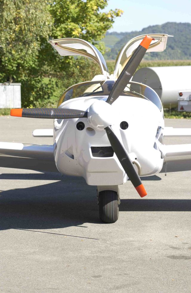

Hi all,
I am just about ready to order my cs prop. I was set on the Woodcomp. The company came back with the question "curved or straight" blades!
My question now is: Did anybody on this list has some comments on the new curved design from Woodcomp? Attached you find pictures from the curved and straight blade design. I could not get good advise so far which would be better for my Tri Gear Europa XS with a 914. Are there any performance data available?
Thanks in advance
Michael Grass
Europa XS TriGear, 914 Rotax

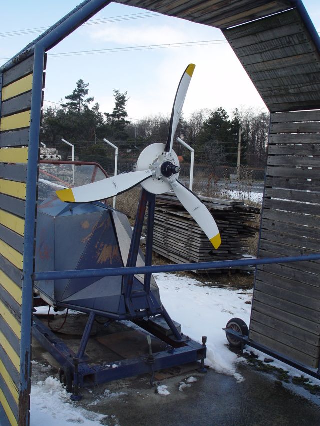

data available?
Thanks in advance
Michael Grass
Detroit, Michigan
<< Europa___blade_type_B.jpg >>
<< Europa___blade_type_C.jpg >>

Hi! Michael
In the absence of William Mills and David Joyce I can pass on to you some results of comparisons which they did on the Woodcomp propeller.
I know that William has the scimitar shaped blades on an SR 3000. but his engine is the Rotax 912S . ….he also has the control unit by Mark Burton and I know it has a very fast facility to go into “beta” mode (reverse thrust) which I know William makes good use of on his very short landing strip.
Unfortunately William and David have just left on “ The Last of the Summer Wine Tour” round France so will be about a week before returning and then on or about the 17th Sept. they go on the Canaries Trip for 10 days.
However the chart I’m providing will serve as a point of interest until you can get a direct dialogue going with them either between the aforementioned trips or after.
Bryan Allsop also has a Woodcomp Propeller but I know it has the straight blades on a 912S as has Davids but David has the Rotax 914.and I think his propeller is the 2000SR.
Mark Burton who has developed a superior controller for the Woodcomp may be able to discuss some features with you in their absence. His e-mail address is:-
Mark Burton markb(at)ordern.com (markb(at)ordern.com) But I believe he is also intending to do the Canaries trip as indeed I will be with Bryan Allsop.
I attended a conducted tour of the Kremen/Woodcomp factory with the group which went on the first “Six Nations Tour” and I am pleased to confirm that they have a very dedicated and professional team working to exacting standards producing propellers with excellent quality at very advantageous prices.
Best regards
Bob Harrison.
Herewith the document mentioned above……….I’m not sure, however, that the tables are for the scimitar 3000SR blades though.

PostPosted: Sat Sep 09, 2006 10:47 am    Post subject: Woodcomp CS curved propeller type Reply with quote
All,
thanks for the replies. This prop looks promising with the preliminary data and, Fred I agree, very cool on the aircraft. I have ordered it now. :<))
The sad part is: It will still take a while before I can give a report on the performance because of my building progress. :<(

PostPosted: Mon Sep 11, 2006 4:39 am    Post subject: Woodcomp CS curved propeller type Reply with quote
Michael, I have been away last week, but am sure you have made a good
decision. The SR3000 is an impressive prop and the curved blades certainly
seemed to have an edge over the straight blades in the tests that I helped
William Mills do on his plane. Regards, David Joyce
