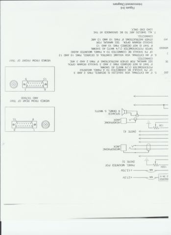

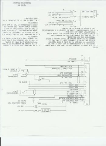

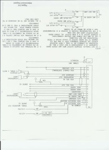

Bob
Here is the drawings for the Terra 760-D in regards to dealing with the shields and grounds.
Dennis
