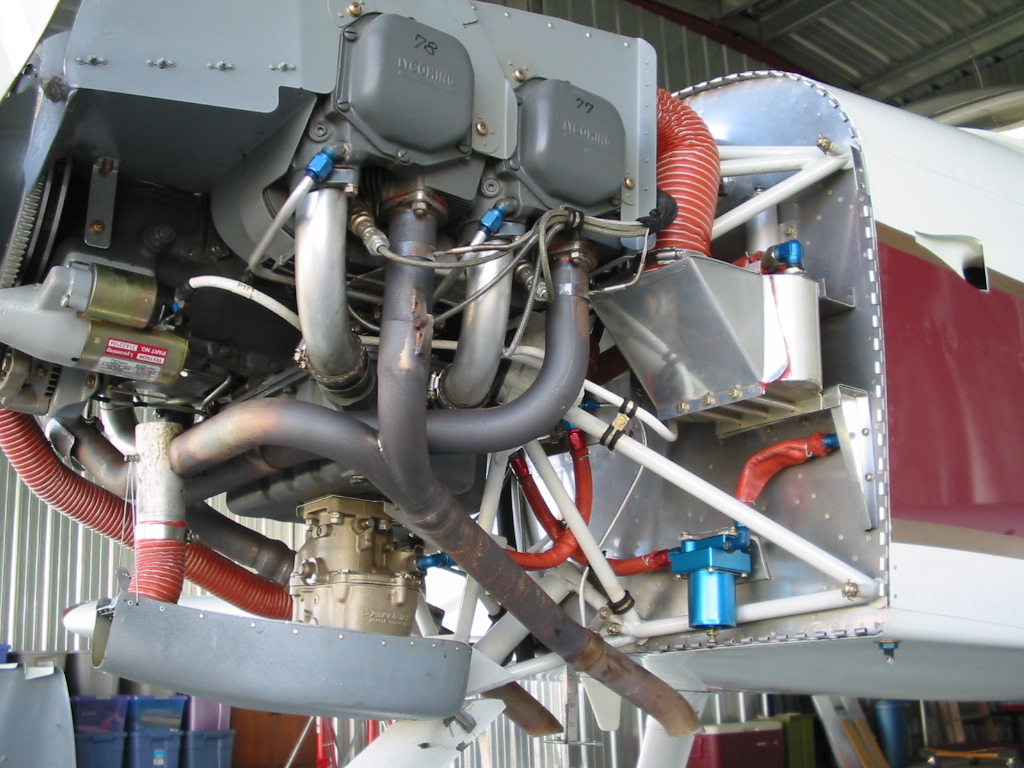

PostPosted: Wed Sep 06, 2006 5:12 pm    Post subject: 10 Vane Oil Cooler Reply with quote
Barry,
Our oil cooler came from Vans, 4/11/2001, part number 4215, per Vans
invoice; "EA OIL COOLER 4215, OIL COOLER FOR IO-360". I had forgotten our
cooler was for the IO and not the "O" model, but I would recommend it.
We have the O-360, 180 hp. I will try to find the mfg info next time I take
the bottom cowl off. Maybe Vans can tell you who makes the #4215.
Pic attached.
Dale
 Filesize:  250.87 KB
 Viewed:  229 Time(s)
klwerner(at)comcast.net
PostPosted: Wed Sep 06, 2006 7:19 pm    Post subject: 10 Vane Oil Cooler Reply with quote
Dale,
Yours looks like a PosiTech Cooler to me...

Dale:
I'm getting back into the oil cooling mode and doing some research.  I looked up the part number you gave and was able to get to ACS web site where they gave a description and sizes of the cooler for your part number (OIL COOLER 4215, from POSITECH). It is listed as a 8 row cooler, is yours an 8 row cooler? I saw one on an RV-6A and if I counted correctly it was a 10 Row Cooler. I will have to get back to that plane and take some measurements because I have had different opinions on How to Count Rows. My feeling is a row is the part where the Oil Passes Through. Some say it is the part where the Air Passes Through, what is your opinions?
The part number for the 10 Row Cooler is: POSITECH # P20005C and ACS # 4216. The BIG difference is the 10 rows and it is 1" Longer.  Dale, thanks for the picture also, nice mounting job. Would you happen to have a picture face on to the fins so I can see what the difference might be between the 4215 and 4216?
What are your opinions?
