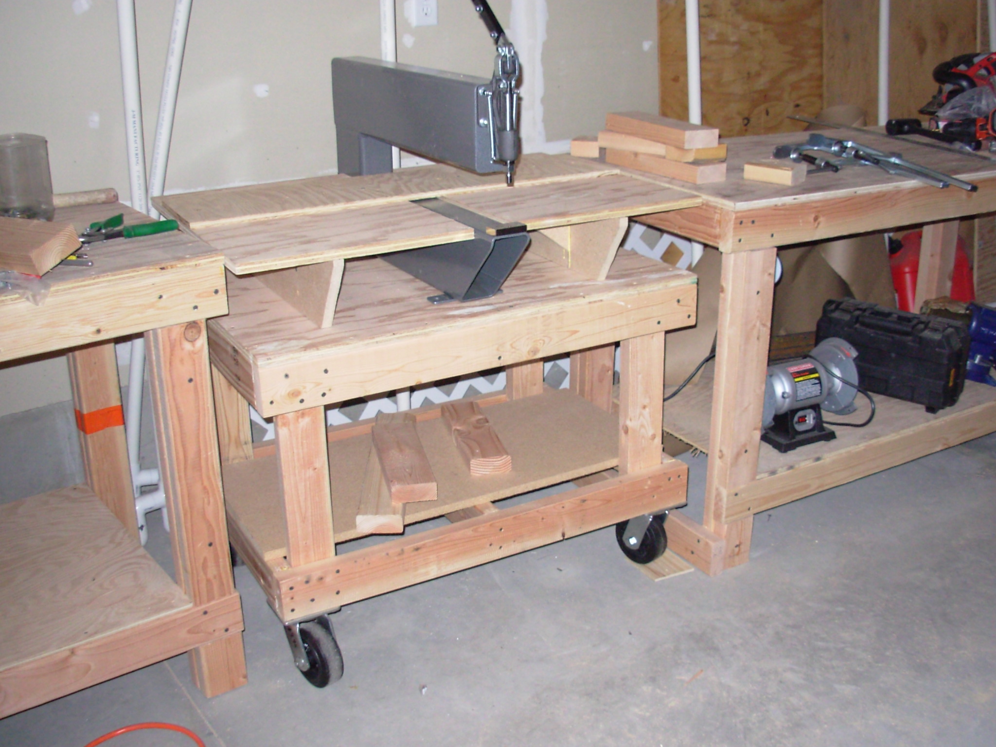

Les, This is the table I made. The EAA tables are level with adn suppor the work.

The table is 2' X 3' . I started with the EAA table dimensions and I shortened the legs the height of the DRDT-2 table and wheels combined, placed the bottom shelf on the bottom to provide a larger bearing area for the wheel frames. The sliding table is much like the table in the DRDT-2 plans. I used heavy wheels to provide ballast to the table.
My son was here for the weekend, and he worked one summer in a belly landing repair shop. He LOVED it ------- until I showed him the pneumatic squeezer.

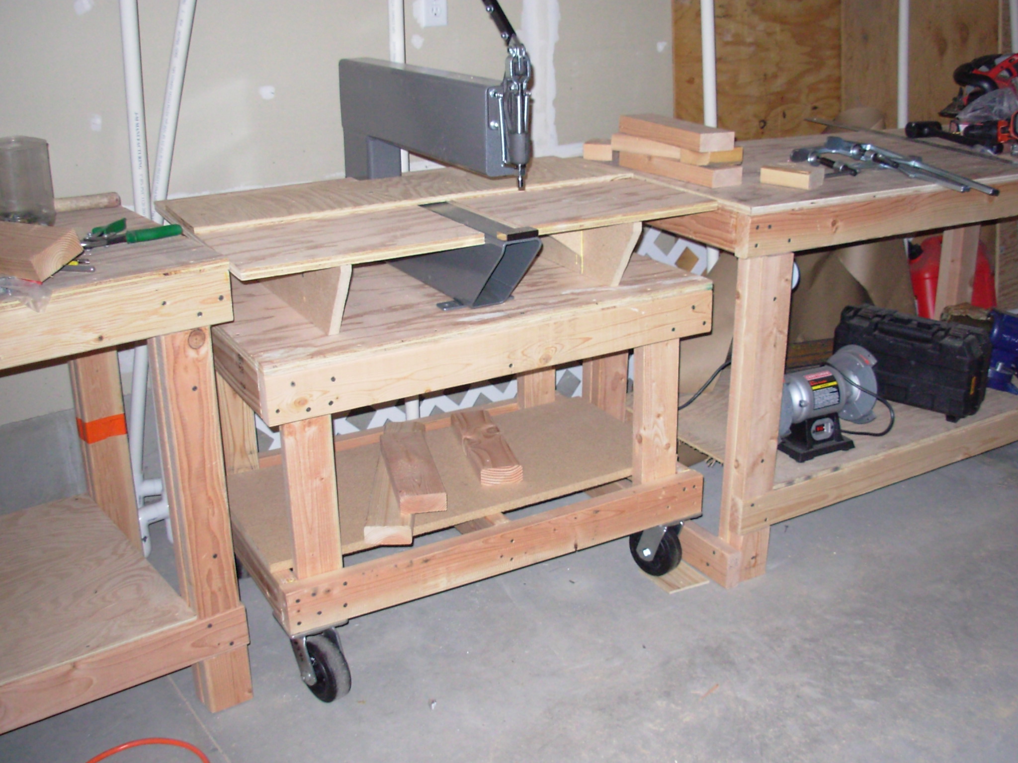

I built two of the EAA work tables and am very happy with them. I
built the DRDT-2 table from the plans that came with the DRDT-2 and
it is great. Here is a photo of the DRDT-2 table.
[IMG]
