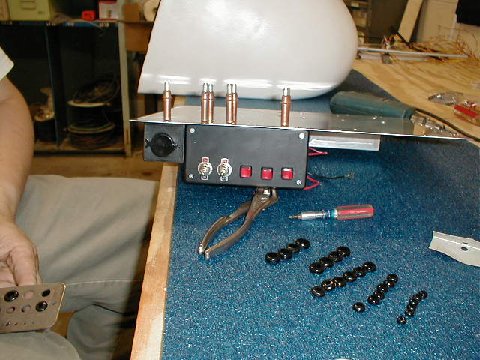

Here's what he remote buttons look like (they're are "3" - one under
the helmet plug).
Just for those that don't know what the remote buttons on the EIS
system looks like.

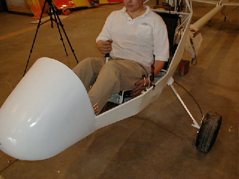

I installed the remote switches under the seat pan so all I do is reach down and push the corresponding button.

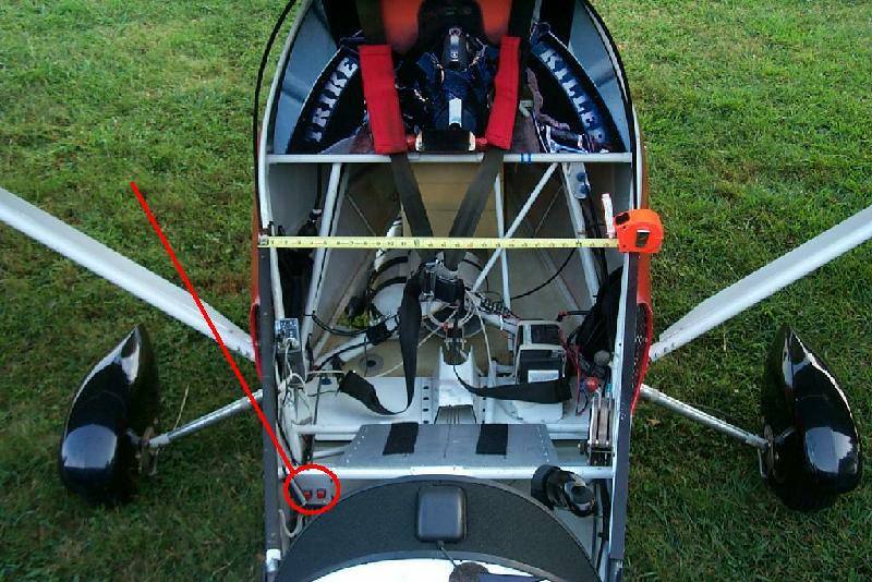

Or there is this method of mounting the eis buttons.
Larry, Oregon
