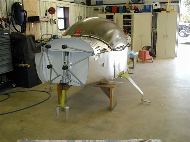

rstone4(at)hot.rr.com
PostPosted: Sun Oct 15, 2006 7:29 am    Post subject: Trailering The CH701 Reply with quote
Steve,
I cannot say I am from a more glorious outfit but very effective anyway. I am retired US Air Force. The only people who get into combat in the USAF today is the officers. The only positions on air crews today that are filled by enlisted is radio operators and load masters. They are on cargo aircraft only. All tactical combat aircraft have an all officer crew. During the second world war the situation was quite different because the bulk of the crew of a B-17 or a B-24 were the gunners. The 8th Air Force conducting bombing operations over German occupied areas of Europe suffered loses of up to 67% until the North American P-51 Mustang became available. After that loses to enemy fighters went down to almost nothing. I went in right after the war in 1946 and have never heard a shot fired except on the rifle range.
Tell me what you are building and how far along you are. I am building a ZodiacXL with the Jabiru 3300 engine and expect to be finished this November or December. I have enclosed a picture.
Bob Stone
