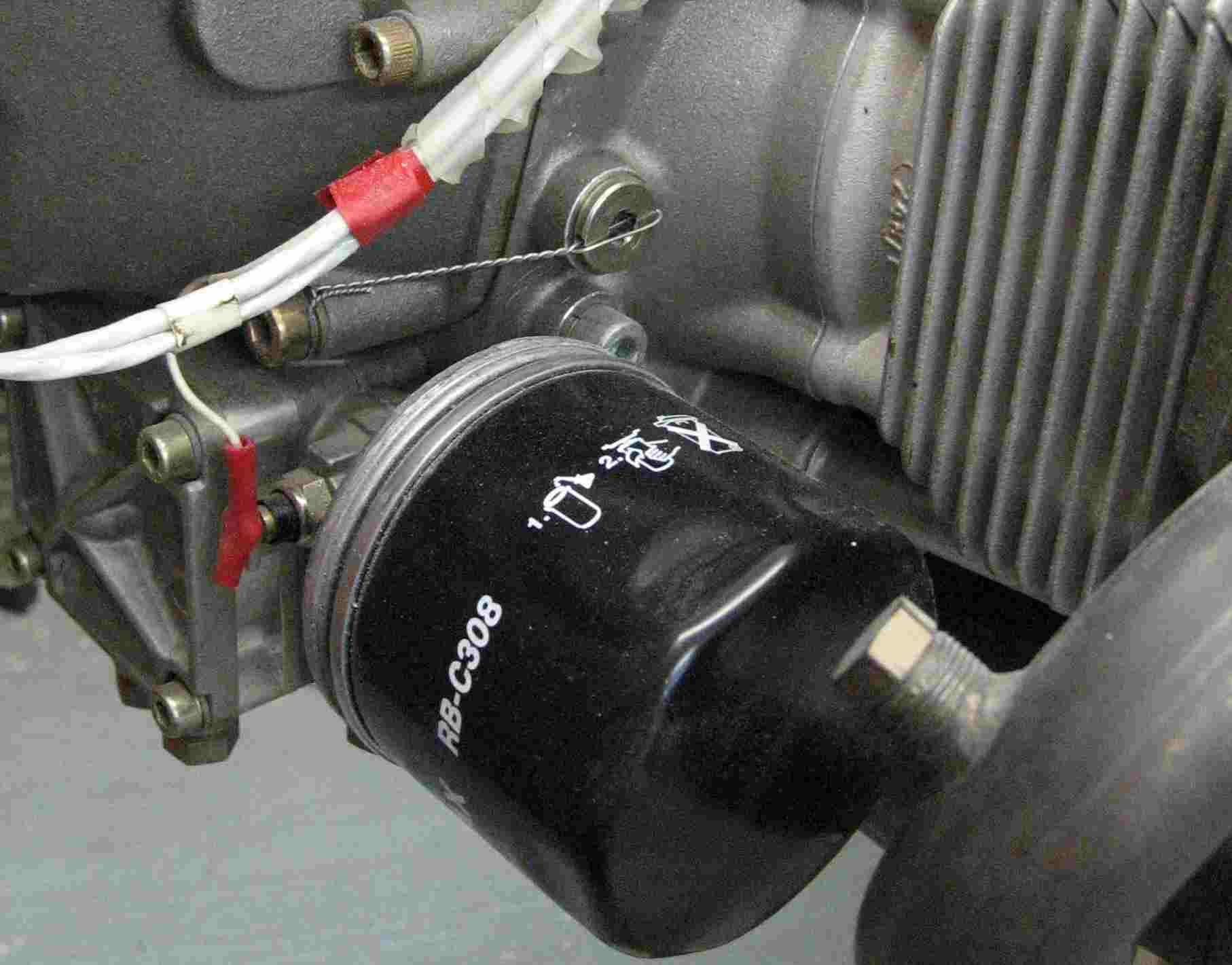

PostPosted: Thu Oct 19, 2006 9:54 am    Post subject: IMPORTANT! - Release of MANDATORY Rotax ALERT SERVICE BULLE Reply with quote
Ian
Where is this plug. Is it the one we remove at the bottom of the oil tank to
drain the oil ?
Alan
riddon(at)sent.com
PostPosted: Thu Oct 19, 2006 10:56 am    Post subject: IMPORTANT! - Release of MANDATORY Rotax ALERT SERVICE BULLE Reply with quote
Alan.
The plug is not the one at the bottom of the tank. From memory, it is
on the port side of the engine, right at the front and just below the
gearbox. It has a fairly large head, coloured gold (cad plated?) and
is, I think, the only Torx head bolt in that area. You don't need to
drain the oil to check it but as Ian says, wire lock it after refitting.

PostPosted: Fri Oct 20, 2006 12:32 am    Post subject: IMPORTANT! - Release of MANDATORY Rotax ALERT SERVICE BULLE Reply with quote
Alan
Your question "Where is this plug".
The plug is on the port side of the gearbox (centre of attached picture)
and mine is wire locked.
Ian Rickard #505 G-IANI XS Trigear
Europa Club Mods Rep (Trigear)
e-mail mods(at)europaclub.org.uk
or direct g-iani(at)ntlworld.com
 Filesize:  85.23 KB
 Viewed:  254 Time(s)
jeff(at)rmmm.net
PostPosted: Fri Oct 20, 2006 4:55 am    Post subject: IMPORTANT! - Release of MANDATORY Rotax ALERT SERVICE BULLE Reply with quote
Ian,
You may want to consider placing a large hose clamp around your oil
filter. Place the screw of the clamp to the front. The run your locking
wire from the plug to the screw on the clamp. This will safety wire the
filter as well. 2 birds with one stone as they say.
Best Regards,
Jeff
N128LJ / Gold Rush
