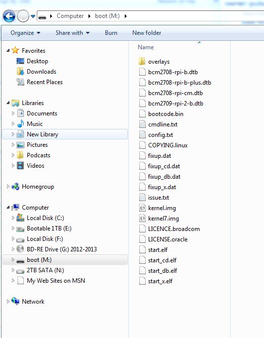

PostPosted: Wed Mar 16, 2016 3:58 pm    Post subject: ADS-B with Avare's ADS-B Pro Reply with quote
I’ve attached a screen shot of my Stratux SD card, a known working install.
Phil

lwheat2083
Joined: 03 Jan 2014
Posts: 33
Location: Moses Lake, Washington
PostPosted: Wed Mar 16, 2016 4:08 pm    Post subject: ADS-B with Avare's ADS-B Pro Reply with quote
I can open the boot BUT the .img is grayed out. Cannot open-can you? Cheers

phil(at)ishml.com
PostPosted: Sat Mar 19, 2016 4:35 pm    Post subject: ADS-B with Avare's ADS-B Pro Reply with quote
I’m guessing your “xxx.img” files are grayed out because you don’t have a program installed on the machine to open that file type. When I select the “xxx.img” files it automatically launches my disk builder.
Phil

lwheat2083
Joined: 03 Jan 2014
Posts: 33
PostPosted: Sat Mar 19, 2016 7:30 pm    Post subject: ADS-B with Avare's ADS-B Pro Reply with quote
I am completely out of ideas. I am going to put it on the shelf for now. Maybe something will turn up later. Thanks for all the help from the group. I guess thats the way it goes sometimes. Cheers, Larry N853LW J250 Moses Lake, Washington
