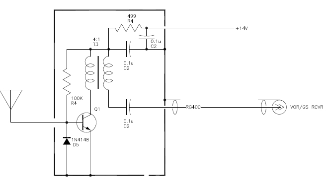

Bob,
Have you been able to assess the active VOR antenna? We’re about 30 days from first flight and really need a retrofit VOR antenna solution for this bird as we discussed.
James
From: Robert L. Nuckolls, III (nuckolls.bob(at)aeroelectric.com)
Sent: Wednesday, December 03, 2014 11:14 AM
Subject: Toroid beads VOR antenna vs. Active VOR antenna
[img]cid:22E5D2A251FF411890F9053FEEDC3653(at)DEFIANT2600[/img]
I may mount one of this things on my roof and
see how it compares with monitor antennas I
have for listening to local city, police and
fire services.
I have one HF active antenna up there already.
http://tinyurl.com/ou2ezdy
The 'antenna' part of this critter is only a
few inches long. I don't have any other HF
optimized antennas up yet to compare it to . . .
but this 'lump' on the end of a piece of coax
hears 'lots of stuff'. Given that the 'stuff'
of which VOR is made (high power, line of sight)
it seems that our little experiment has a high
probability of success for replacing the legacy
dipoles and whiskers so favored by our TC
brothers.

Bob,
Hope springs eternal....  A wideband RF amp such as this on a tiny antenna, while it may be OK, even great for a rooftop monitor, is not going to be a satisfactory substitute for a tuned VHF nav antenna in an aircraft. Overloading, crosstalk and s/n ratio are some of its inherent deficits. It may seem to be good enough testing in the boonies, but ..
Try it. Play with it. But don't proceed in a way that you can't re-do easily.
Ron

At 03:06 2015-04-25, you wrote:
Bob,
Ron
There's no 'hope' about it . . . performance of such
devices are well known . . . as are their shortcomings.
Nobody is talking about a free lunch here. The goal
is to explore an option for getting a VOR antenna
into a uniquely unfriendly space . . . into a tube
buried in a leading edge.
There are no promises or expectations for equivalency
-OR- resistance to the effects of inter modulation
distortion. The expectation is that it will offer
serviceable VOR performance under SOME conditions
with reservations.
It's a certainty that shortcomings will have to
be evaluated by the user. I've not fired up a
VOR receiver in the last 200-300 hours in the
log. The active antenna is a minimum effort,
low cost way to squeeze a bit more utility out
of a dying technology for this user in one airplane.
No warranty implied - it's a "caveat emptor" of the
first order.

What is the length of cable from the
end of the antenna to your receiver?
berkut13(at)berkut13.com
PostPosted: Fri May 08, 2015 10:05 am    Post subject: Active VOR antenna Reply with quote
About a 24-30" run between antenna location and Garmin GTN-650 radio.
I would plan a short pigtail ~4" off the end of the antenna with a female
BNC connector. Similar with the power wire. To allow the canard to be
removed for maintenance and inspection, connectors local to the antenna
installation area are required.

Hi James,
What are the physical sizes of the area that you have to install an antenna? I am guessing from what has been posted, that it is a tubular space in each canard accessible from the root. Is the canard glass and the nose of carbon? What is the spread between the canard roots?
I started simulating, modelling and lab testing antennas a few years age for my own plane and my own entertainment. Your application looks like it may be a challenge for a conventional solution, but who knows.
Ron
PostPosted: Sat May 09, 2015 11:12 am    Post subject: Active VOR antenna Reply with quote
A challenge, for sure.
The concept here is to retrofit an active (amplified), end fed, single
element antenna into the LE D-section of an existing canard on one side.
The canard is glass skinned and will be invisible to the antenna. However,
the center spar caps are carbon and the typical retrofit of adding a foil
"V" style antenna to the exterior of the bottom skin is not ideal. A
"dipole on a stick" was the original idea, but there is no space to get the
coax away from the elements.
The canard is solid foam core, in which a conduit was drilled out in the LE
running from the center to one tip. This will be where the antenna will be
inserted. There is a small "access box" (if you can call it that) cut in
the foam at the center of the canard where the antenna can be accessed,
however once installed and the skin in patched, it will require cutting the
fiberglass repair patch off each time. Sounds worse than it really is and
is actually less work than installing the external foil elements and trying
to re-contour the already critical profile of a small airfoil.
Fingers crossed this works!
-James
