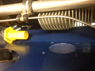

To really fix it you need to increase the airflow behind the #5 cylinder. Ultimately the only way I was able to get #5 in line with the rest of the cylinders was to trim the front dams to around 1/3 of their original height and then to modify the rear baffle by extending the stock slit to come up further on the baffle and allow the straightening of the top bend to obtain a 1/8th inch gap behind the #5 cylinder. I used RTV to fill in the gap created by the mod. I ordered a new baffle piece to modify and install at the next annual to eliminate the RTV. Below is the best photo I can find. I did not file any of the fins, I just made sure there were no leaks. My CHT will rarely get to 400 in a climb unless its over 90 degrees OAT., and that's only in an extended full throttle climb. I typically climb out at 120kts.
