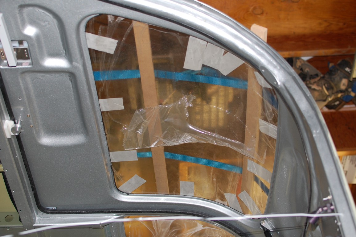

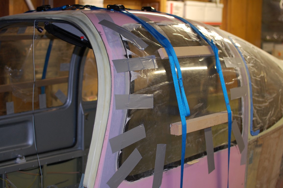

Hi everyone. I'm ready to attach the windows in my RV-10 and am looking for advice on those who have used the Lord 7545 A/E adhesive sold by Geoff at Aerosport Products. After reading lots of positive comments from here about it, I obtained a few tubes from him.
The plans call for installing the windows onto the doors when the doors are off and laying flat, presumably to allow gravity to help hold them in place while they are being cured. Of course, the rear windows can't be installed with that luxury, but they're smaller and lighter. And the windscreen rests largely on the nose while curing, so that should be less of an issue too.
But my question is, considering that Lord Adhesive is different than Vans' would have us use anyway, is it sticky enough that I could install the windows on the doors while the doors are closed and on the plane - in essentially the same orientation as the rear windows? The reason I ask isn't due to laziness Smile But instead, I'm one of the lucky ones whose doors ended up fitting quite well without a lot of work. And I figure that if the windows are attached to the doors while the doors are in their proper latched position, they can only help (slightly) to further stiffen the door in the proper position. The last thing I want to do is to fit the windows to the doors when the doors are on the floor, and then find that gravity warped things slightly while they were curing, and the doors no longer fit properly. It would seem to me that adhering the windows to the doors when the doors are in their closed position will help keep everything aligned properly, so long as the Lord adhesive is sticky enough before fully cured that it will hold the window tightly to the door and in place while it is curing.
Thanks!
Dan

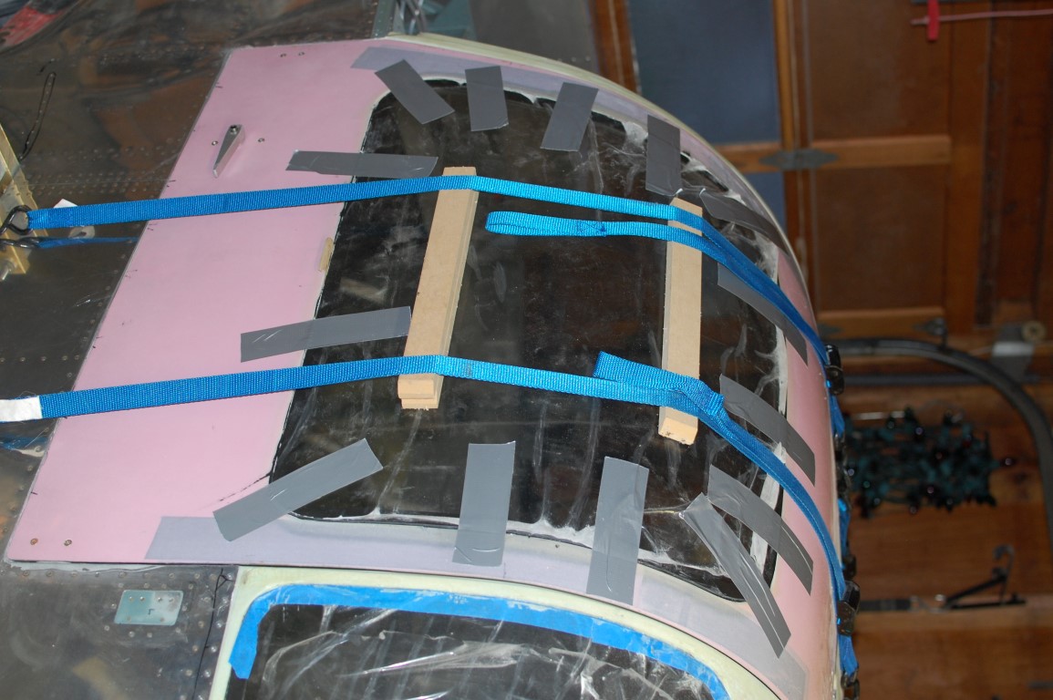

The short answer is no. You need minimal pressure to hold the windows in place. If gravity causes any movement at all, you're going to have a major headache on your hands to resolve. I did my doors laying flat. On the rear windows I made fingers out of scrap aluminum to hold the pieces in place that were cleco'd to the cabin cover. You could do the same on the doors. The angle of the bend determines how much pressure is applied. You don't need much, just enough to keep things from moving.

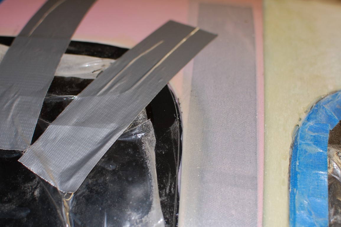

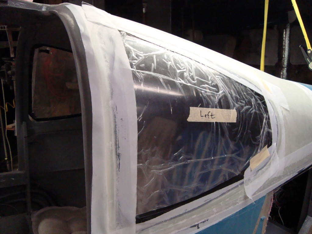

Attached photo shows the "not too tight" straps and insulating foam blocks
to attached the rear windows. After gluing I filled in the seam with micro
balloons, sanded flush, then two bids of medium weight glass over the seam,
then more micro over the fiberglass to fair in (second photo). No paint
cracks after three years.
I also used Hysol for the adhesive as it had a good record with the Lancair
crowd:
http://shop.lancair.com/inventoryD.asp?item_no=9360-QT&CatId={992B7B06-E01B-
4918-BB0C-79343CDB7869}
It worked, but I suspect the other options work just as well.

I did not use the Lord adhesive as I copied Dave Saylor's method using
Silpruf instead. Silpruf almost has a proseal consistency so it might be
less viscous which lends itself to this process a bit better maybe?
I glued the door windows in while attached to the plane. I used several tie
down straps and blocking to apply even, light pressure to the windows as
well as duct tape to keep them from moving. I did this for both the door
window transparencies and the fuselage ones. I think they came out ok but
the only air time my project has seen is dust falling on it in the garage so
YMMV.
See pictures.

would
same
well
help
thing
curing,
keep
place
while it is curing.
Thanks!
Dan

Thanks, everyone, for the great response.
I never even thought of using aluminum "fingers" like that (or straps and foam blocks as others have done). That's a great idea, and so simple too and straightforward too! I guess that even after getting this far with fibreglass, I still don't automatically realize that it's OK to drill holes where you don't want them permanently!
I'm definitely going to try this idea, and with the doors on and shut for good measure too instead of on the bench (can't hurt!).
Thanks again!
