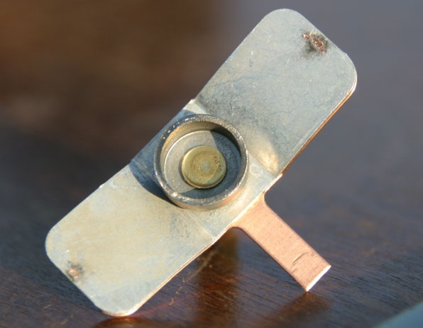

Contactos all have one characteristic in common,
they BOUNCE. Some worse than others but none are
zero. The designs that come very close to zero
are those specifically designed for starter control
service. Very light moving contacts. Lots of closure
pressure. Small contact area.
[img]cid:.0[/img]
These contacts have hundreds of start cycles on them with
what was probably a healthy battery. Drop the battery
to 10% capacity . . . the contactor will close but it's
going to burn on each bounce and perhaps stick.
If battery voltage is not 12.5 volts or more with
the master switch just closed, be cognizant of the
risk for contactor sticking that goes up exponentially
as battery condition goes lower.
Your starter contactor is probably fine but suffered
an unrealistic expectations event.

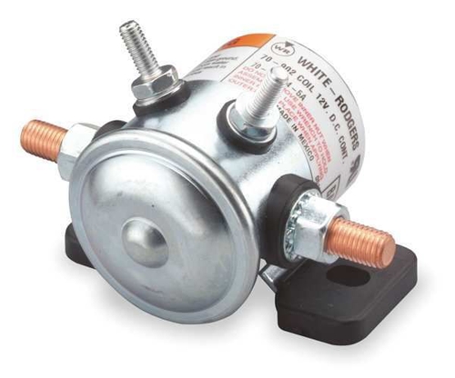

The so called intermittent duty, whisky barrel
contactors . . .
[img]cid:.0[/img]

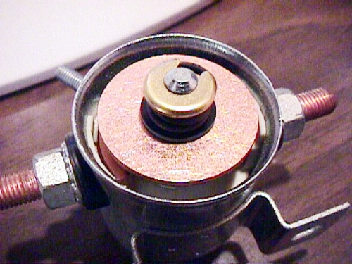

were never designed for starter motor service. Power
winch, hydraulic lift gates, etc, yes. But starter
motors . . . not so much. The problem got worse when
the TC guys starting bolding PM motor starters to
their products. Starter inrush currents went up
and the massive, copper ring that served as movable
contact
[img]cid:.1[/img]
is bouncy to the extreme.

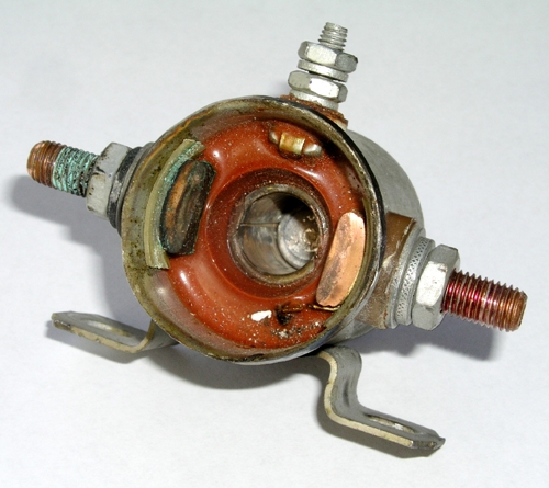

When Cessna went to the floating cowl way back when, rain
running down the firewall of a sun-soaked airplane sometimes
splashed a contactor body which cooled and sucked in moisture
under the crimped-but-not-sealed closure cap. Moisture
sucked in as liquid had to escape as a gas during atmospheric
variations in pressure. Needless to say, the humidity inside
the contactor was 100% and guess what?
[img]cid:.2[/img]
Things got kind of cruddy inside . . .
[img]cid:.3[/img]

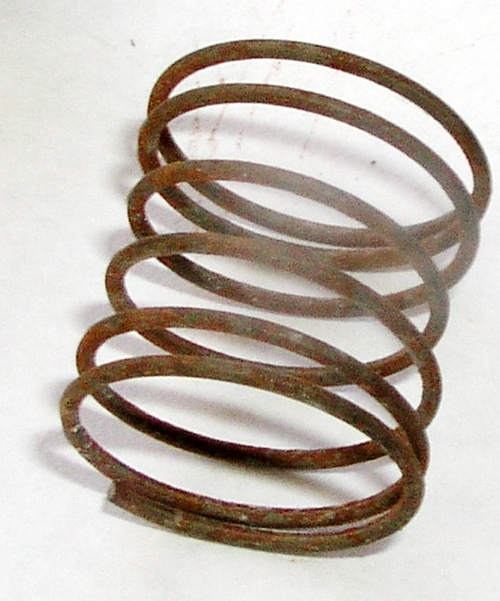

There was a ABORTIVE fix tried wherein all contactors
were 'sealed' around the terminals and the crimped
cap. The results were predictable. Failure rates went
down slightly but since the sealing was not hermetic,
liquid was still sucked in and vapor exchange went
down further.
The most effective FIX was to mount the contactor cap-down
and drill a tiny 'drain hole' in the center of the
cap. Actually, the hole served both as a vent to
reduce that sucking tendencies as well as
a more reliable exit strategy for any liquid
that would pool there.
Bottom line is that the whisky barrel contactor
has always been a poor performer as a starter
contactor 'Better gravity' won't help and
uckum-yucky over the openings is useless.
