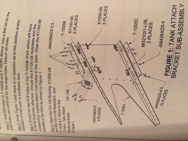

Just curious. I'm trimming up my wing root fairings and am running into a problem. Going back, I think I've found it.
Attached is a photo of 18-5. They call for a dimple in the T-1005B (upper) shim. But the plans don't call for dimples in the T-1005C (lower) shim.
The skin is dimpled (as called for under in the wing attach section), but this substructure isn't.
Am I missing something in assuming these bottom shims need to be dimpled too? Or is there something I don't know/understand.

With photo this time.
Phil
