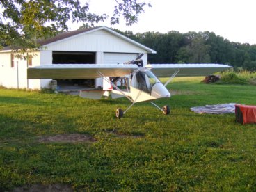

Getting close...just two months behind schedule.... Pic resized for Bro
Pike . Smile

   Unfolded the wings and was prepared to start the engine for the second time...wings on....forgot to install the pull rope pulley and bring the handle through the hole in the back of the cockpit....Smile   Just goes to show...always something!!  Herb
