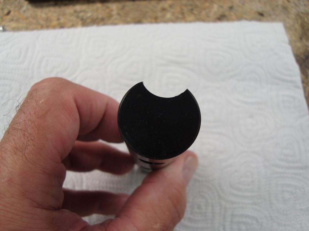

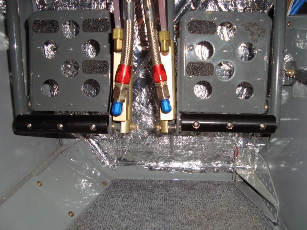

My son and son-in-law are both Naval Aviators. As is easy to do, both have a tendency to drag the brakes. A good friend of mine, Tom Doran, made these extension on his milling machine from 1” Delron. He even made me one out of steel for me to use as a drilling gig. I used a couple of hose clamps to attached the gig and drill the #19 holes.
While I did this to help the son and son-in-law I confess I found them to be much better than just the stock set up.
Carl

mlskunkworks sells these. I put them on my RV-10 and they are great. I have flown RV’s without them and am very glad I have them.
