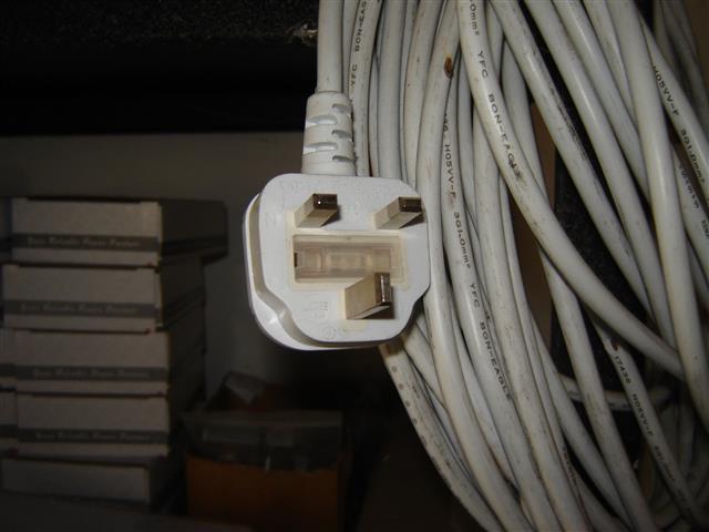

During the lull in aerolectric posts...
What's the simplest way to use US 240v to power a EU 240v (at) 150w machine. The EU machine uses a single hot leg, neutral and ground through the plug in the picture attached.

That's not a EU plug, it's our standard 'ring main' plug here in the UK: the plug as you look at it (upside down) has three pins, the longest (at the bottom of the picture) is the earth, first to go into the socket when inserted and last to leave when removed, the pin on the left is the neutral, and the one on the right (as viewed) is the live and is fitted with a fuse up to 13amps ie: 3000watts (maximum load) divide by 240volts equals 12.5 (13amps)
I presume you have similar 'wires' in USA ie: Live, Neutral and Earth

The plug you've pictured is actually "British Standard" not EU, but simply
connect your two North American 240 volt hot lines to the "line" and
"neutral" of the British plug and ground to ground of course and you're good
to go. (Ignore/don't connect, the North American neutral.) As someone else
mentioned if this is a permanent conversion, cut off the British plug,
attach a NEMA 6-15 North American plug http://tinyurl.com/nfrrzrx the
matching receptacle such as this http://tinyurl.com/pags86c , and you're
set.
If you don't wish to modify the existing plug, here's the matching British
receptacle. http://tinyurl.com/qcqqd9p
By the way the British plugs are internally fused (at) 13 Amps so the concern
for connecting to a North American dryer or stove circuit is minimal as long
as you retain the existing plug. (you can actually see the fuse in your
photo)
photo)

wrote:
robert.mccallum2(at)sympatico.ca>
The original question was for the "simplest" way to operate the UK device
on
a North American power system. The "Simplest" way is what I described. No
transformer is required. A 240 volt device is a 240 volt device no matter
which side of the ocean it resides on. In the UK (or Europe) 240 volt
single
phase devices are connected between a "hot" line and a "neutral" (grounded)
line. In North America that same 240 volt single phase device would be
connected between the two live line connections (L1, L2, as you've
described) and not connected to the "neutral" (grounded) connection. In
either case the actual "ground" (earth) connection would be made as usual
jonlaury
Joined: 06 Nov 2006
Posts: 336
PostPosted: Mon Oct 19, 2015 8:05 am    Post subject: Re: US 240v to power EU 240v machine? Reply with quote
WOW!
From the response to my rather pedestrian dilemma, and with no competing posts, it sounds like there's a bunch of Aerolectric List junkies needing a fix ! Very Happy
Big THANKS! to all.
John
peter(at)sportingaero.com
PostPosted: Mon Oct 19, 2015 12:06 pm    Post subject: US 240v to power EU 240v machine? Reply with quote
> Also depending on the iron content 60 cycle motors may tend to
overheat on 50 cycle.
That's interesting, I bought a large 240v compressor when I lived in the
US. Now trying to run it in the UK it keeps overheating and popping the
thermal cut-out. I guess a new motor is on the cards...
Peter
On 18/10/2015 23:53, Bob McCallum wrote:
The original question was for the "simplest" way to operate the UK device on
which side of the ocean it resides on. In the UK (or Europe) 240 volt single
either case the actual "ground" (earth) connection would be made as usual.
My original description in no way suggested connecting together the two
"line" connections creating a direct short as you seem to have interpreted.
Maybe I should have said "Connect your two North American 240 volt hot lines
to the "line" and
"neutral" RESPECTIVLY of the British plug and ground to ground of course and
you're good
to go" to make it clearer.
If that British supply cord were cut open you would find a Brown conductor
which you would connect to L1 of the North American system, a blue conductor
which you would connect to L2, and a green/yellow striped conductor which
you would connect to ground. (green or bare in the American system).
The transformer connections you describe are correct and would work, but the
transformer is not necessary. Simply connect directly to the 240 lines plus
ground.
The only slight difference, as someone else pointed out, is frequency, which
in North America is 60 Hertz and most of the rest of the planet 50 hertz.
This will make a difference in the speed of motors which will be faster on
60 and slower on 50. Also depending on the iron content 60 cycle motors may
tend to overheat on 50 cycle.
Respectfully
Bob McC
Bob McC
