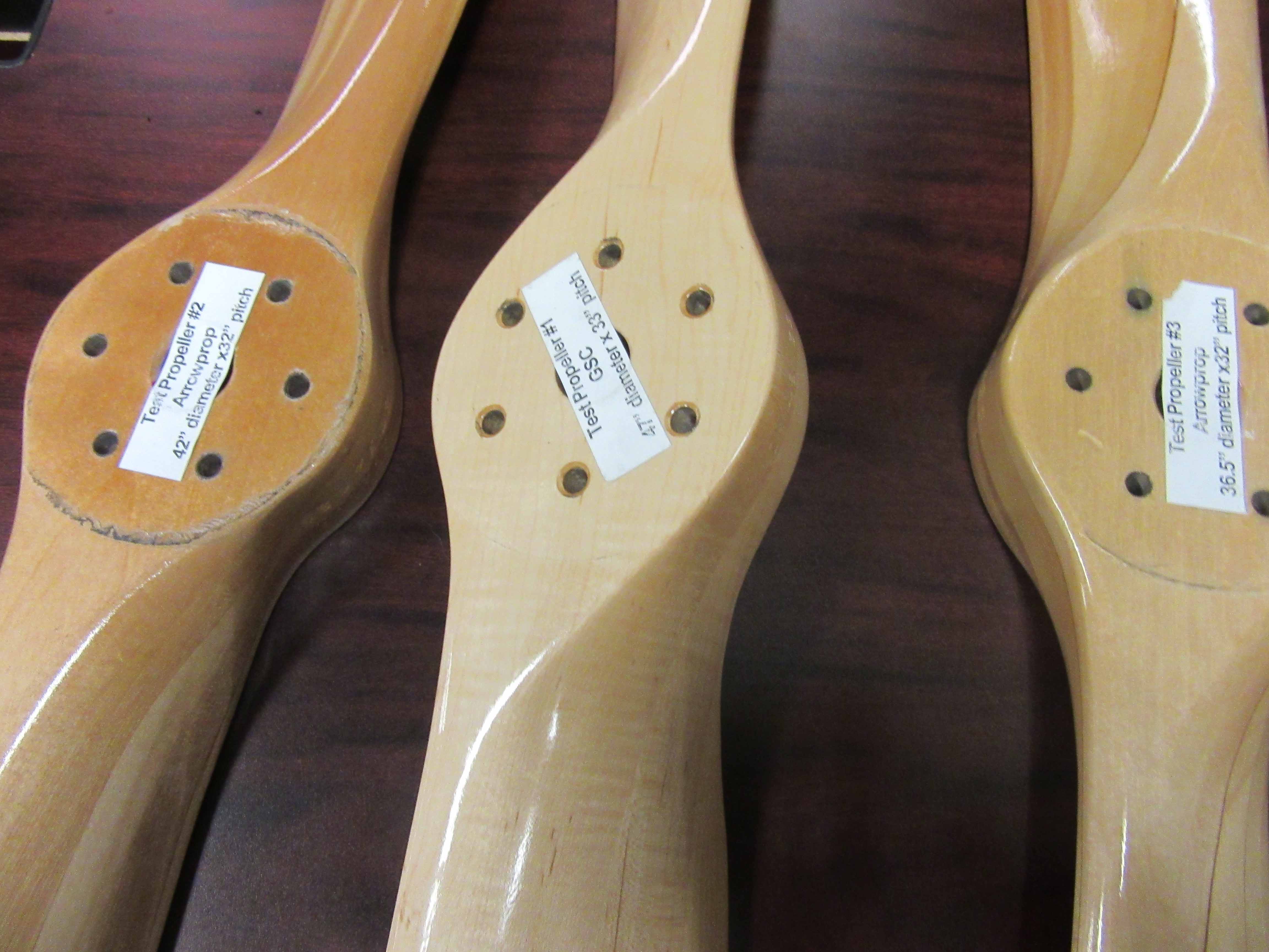

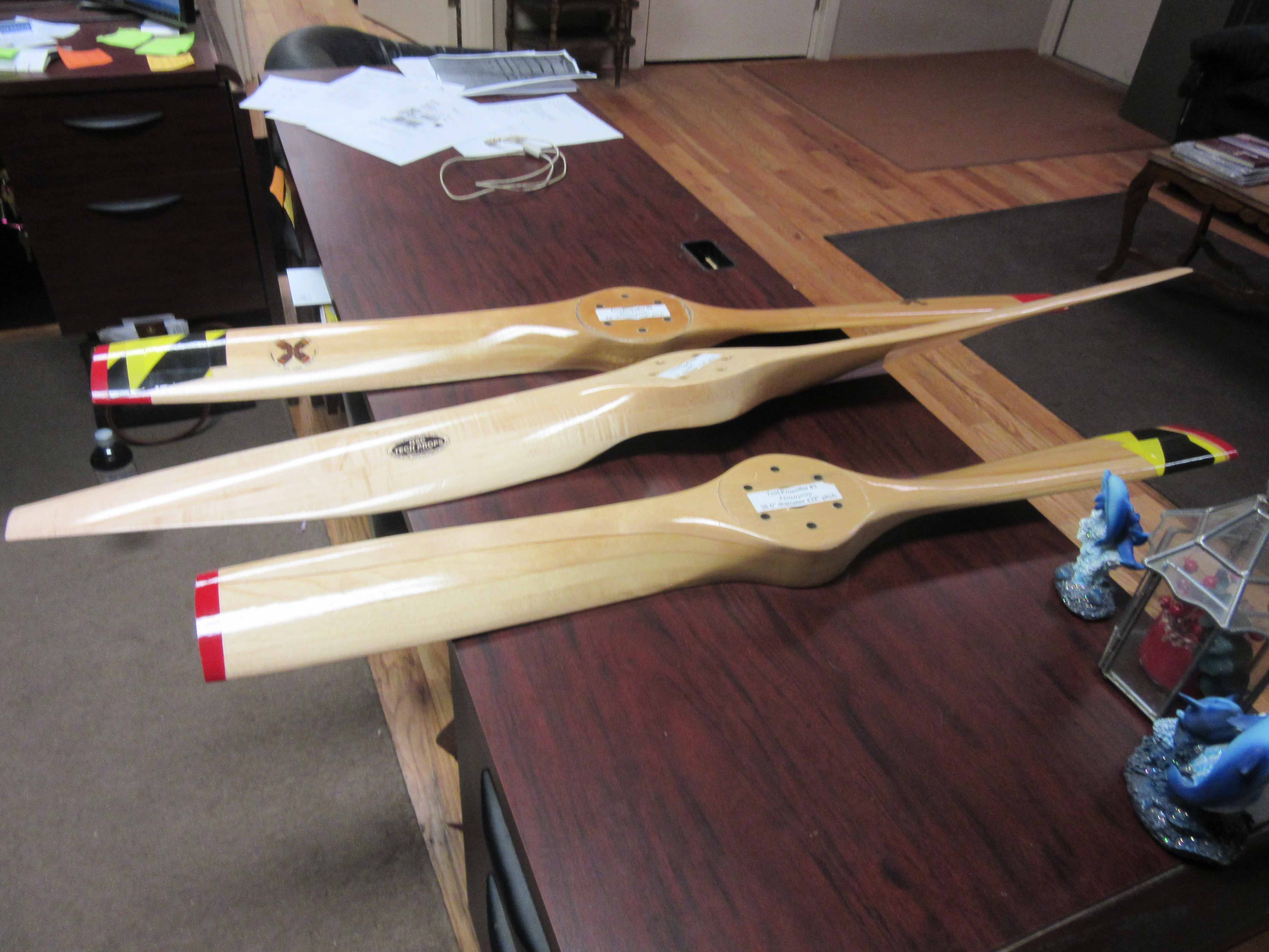

Have my choice between props.
Just wondering which prop is best for a 912 and prefer speed over climb.
Is there some place to call that would know?

    You're showing some weird props there. The square tips look like they might have come off a drone. I'll say, in general, that the longer a prop is the more "efficient" it is because of lower induced drag. (Think: glider wings.) The limitation on length is: 1) dragging it on the ground; and 2) running the tips supersonic. In general, with a 912, the prop RPM is so low you don't have to worry about #2 because #1 limits. Big however for the 912 is the mass inertia limitation. Since inertia varies as the mass times distance from the hub squared you might hit it with a really long 2-blade.
    Second consideration is number of blades. In general, the fewer the blades the more efficient the prop. (Less dirty air.) However, many say that shorter, multi-blade props climb better, whereas longer, fewer blade props cruise faster. Not sure why, but I suspect it's because people over-prop with multi-blade props and subsequently run them flatter, giving better climb performance. (Prop thrust varies as the RPM squared, diameter ^3.5, and square root of pitch. Citation)
    As to brand, I've seen several prop comparisons on 912s and have never seen an appreciable performance difference between any. (Prop design was very nearly standardized by the time of the Wright brothers.) This excludes the radical trans-sonic stuff more recently designed, none of which applies to our vehicles.
