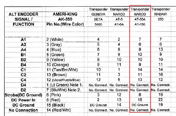

I have a question about the blue and pink and blue wires on my A-350. If my understanding of the schema is right, I must plug these wires together on hole no 8 of my Narco. ?
The image you attached didn't come thru to me but the
data I have on the AK350 Encoder seems to confirm your
observation . . .

The bare wire of the encoder seems no to fit anywhere, but it's usually ground wire. What's the difference with the Black one wich is also a ground wire ?
