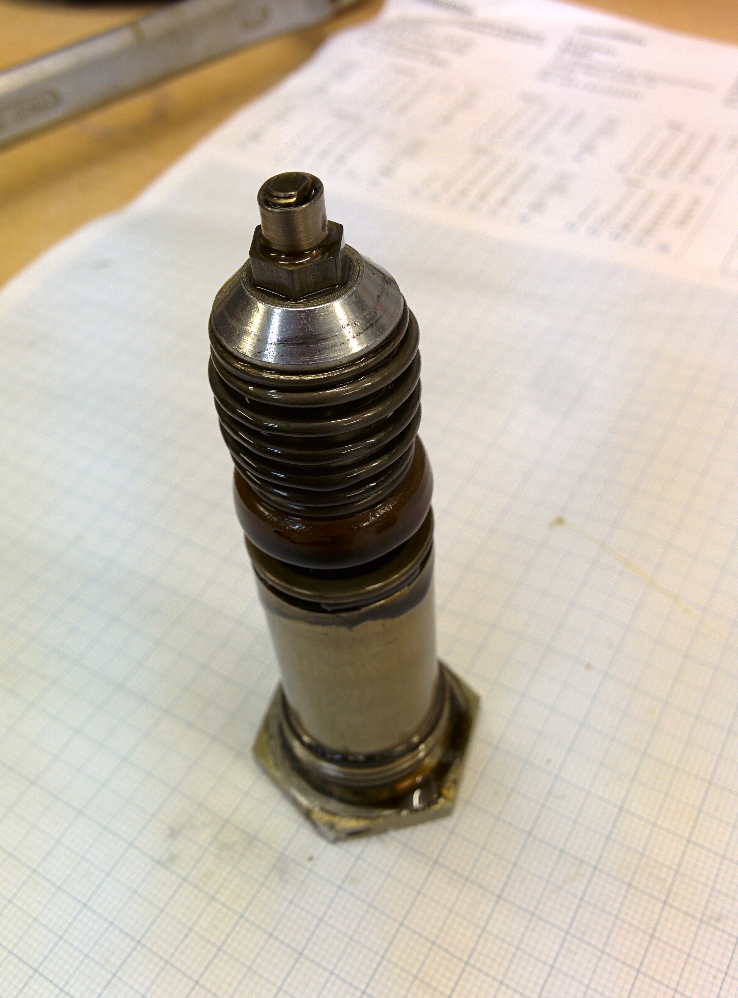

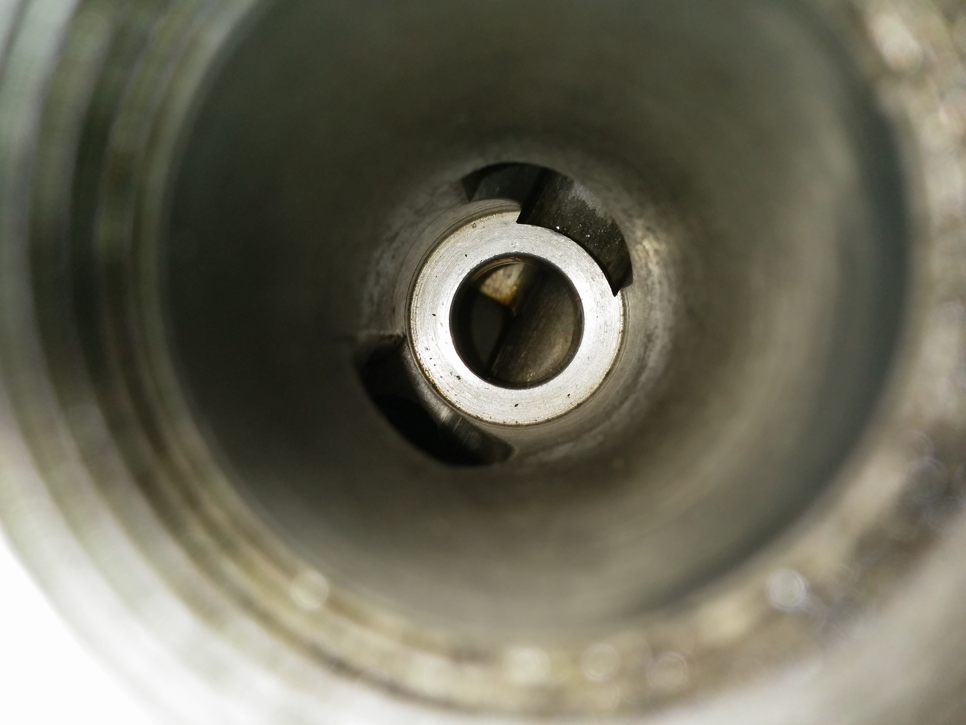

Hi friends,
I have as significant problem with my oil temps which I can not solve by my own.
So this is the background:
Lycoming O360 F1A6, in a Lancair 360 with external cooler connected.
Tried cooler in front of cylinder 2, cooler behind the firewall with air supplied from plenum, as well as air supplied direct from Nava duct.
In all cases temps were much to high with no significant changes.
So I went back to the connections I used to connect the cooler - where I need some support.
So I have an Olli filter adapter with the thermostatic screwed in from below (vernatherm). One of the docs I use says that I still need the oil cooler bypass plunger if I connect to oil cooler connection B (see attached document).
Return line from cooler is not in question I think.
So my question is - do I need the plunger - which is presently not installed  - or what I am doing wrong? - and I mean there must be something real wrong.
One more observation - the oil seams to flow already through the cooler before getting the hot, I.e. warm. So I suspect the oil following either only through the cooler or only partial.
And yes - I will check the vernatherm to - but my questions refers to the plunger.
Thanks for you help

First on our comment that “oil seams to flow through the cooler before getting hot”.  This is exactly what should happen.  When the oil is cold the cooler bypass valve is open allowing oil to bypass the cooler.  That means oil is flowing though the cooler as well a through the bypass valve (see figure #1 of your attachment).  This is why many need to reduce cooling air to the oil cooler in the winter to get oil temps above 180 degrees.  Do not think of this bypass valve like you do a car thermostat.  They are exactly opposite in function.
You did not say if this is a new problem or not.
Not sure about your filter adapter, perhaps a diagram would help.  From what you said I think you have removed the original engine veratherm (oil cooler bypass valve).  Is this correct?  If so I offer this is one of the problems.  This valve must close and shut off bypass oil when the engine oil is hot.
Of note, the one Lancair 360 I’m familiar with had a long history of heat problems.  It got so bad the engine failed on run-up for takeoff.  The guy who did the overhaul said he never saw heat damage like that.  If you continue to have problems you might want to revisit some basics:
<![if !supportLists]>- <![endif]>The oil cooler is just too small.  The one in the above Lancair was significantly undersized.
<![if !supportLists]>- <![endif]>While you have taken steps to improve air to the cooler, what did you do to improve air out of the cooler?  The Lancair above cowl exit was way too small to handle the needed engine cooling air volume.  Airflow requires a differential pressure drop across the cooler.
<![if !supportLists]>- <![endif]>Are CHTs in the 380 degree range in cruise or do they run hot as well?

Peter:
On Lancair's that I have worked on or seen do not have any issues with cooling.  The plenum does a fantastic job of cooling.  You say you have a Vernatherm installed with the Oil Filter Adapter.  SO, why do you are you using another bypass valve?
YOU DO NOT USE TWO Vernatherms or ByPass Valves. Use ONLY the Vernatherm on the Oil Filter Housing.
The Vernatherm stays OPEN at low temps which circulates the oil within the engine.  Once the oil temps are high enough (180 F/85 C) the Vernatherm CLOSES the bypass hole in the engine and NOW the oil flows to the Oil Cooler.
Simple and effective.
NOW!  If you install a second oil bypass valve the oil temperature WILL NEVER get hot enough AT THE SECOND second valve.  And the Valve will NEVER ALLOW oil flow, so the oil cooler will NEVER become part of the cooling system.
NOW!  There are all sorts of questions, I am going to put my foot in my mouth and make an assumption:  That ALL other items are working and are correct.  Some of the questions are:
1 - Is the Oil Filter Vernatherm working correctly?
2 - Is the Vernatherm seat in the engine in good shape?
3 - Is the Sending Unit for the Oil Temp correct?
4 - Is the Gauge the Sending Unit is connected to accurate?
5 - What are the CHT's, are they with in range?
6 - What are the EGT's?  Not that they matter that much, but are they above 1400 F?  <--  This is MY personal limit.  There are NO engine specs on Max or Min EGT.
7 - How big and how many vanes does the oil cooler have?
Location of the Oil Cooler is a little important and I personally prefer to have it right at the cowl inlet.  BUT!  Being that you have a plenum, and again I'm ASSUMING  <--  Hate doing that.  That it is well installed and the lower baffles between the cylinders are in good shape.  SOooo, even if you have a firewall or baffle mounted oil cooler it is doing well.  It should be doing well!
Let's go back to the document you attached:
Please indicate WHICH figure/configuration you have on your engine?  The one on Figure 4 requires a plug to be installed.  Failure to do so will recirculate the oil with in the engine and the oil will NOT reach the Oil Cooler. With the results of high oil temps.
OK, back to you Peter, let's hear what you find after reviewing the above notes.
Barry

Peter:
Haven't heard back from you, have you solved the problem?
Barry
Because it is written in the manual attached in my first mail – see page 5, pic. 4 (…Reinstall Plug… - oh just wait – just the plug…. – my fault.)
Yes – agree, in my case it was called „plunger” so I guessed it is not a Vernatherm – anyhow it is not installed.
I agree – I will not open a discussion who is correct – you or Carl in the former mail – but would like to know which explanation is the correct one…
I agree and that is not the case in my engine.
I learned to question everything – especially in my case as I am running out of solutions…
Next thing I will check – it was checked by the engine overhaul shop…. But will re-check
To be checked – see above….
I tested with an independent other instrument and corrdct at least +- 5-10 degree
Yep
They are well in the grange below 400
They are fine as well. Some differences between cylinders – but not that much
It is a 10 row one from Steward, I guess around 6 inch x 4 inch x 2 inch
Yes it was in front of cylinder 2, well installed and sealed. The only thing I can think of is differential pressure is to small – but on others it is working… (would love to have it there…)
In the meantime trying all possible solutions (which were recommended to me) I installed it on the firewall with air supplied from the plenum during first try and with air from a dedicated Naca duct on a second trial. NO DIFFERENCE… on all three configurations !
Yep, baffles between 1&3 and 2&4 are the original Lycmongs and are really good.
….no – it is – UNFORTUNATELY – not…that´s why I am writing here…L
It is he configuration on page 2, Fig. 2 – Oil Filter adapter with corresponding Type 2 Thermostatic By-Pass Valve installed. Type 1 Oil Cooler By-Pass is not installed – except the Plug as shown. Spring and Plunger not installed.
Wait – I do not understand. Without the Plug the oil will flow out and no circulation at all will happen. Or what do you mean with “plug”? I have connected the oil-cooler to “B” as shown in Figure 4 on page 5 – so have to seal “A” with a plug anyhow… ? It can not stay open…
BTW – is there a way to connect the oil-cooler line to “A” as well and to seal “B” with a plug ? What is the difference ?
Barry

Thanks for asking. No, problem still existing...
I have dismounted the filter adapter and the vernatherm. Pictures attached.
I tested the vernatherm and it works within spec.
So what else can be wrong?

As you have eliminated everything else, you are left with the oil cooler being just too small.
Replace the cooler with an Airflow Systems 2006X cooler: http://www.aircraftspruce.com/catalog/eppages/xseriesOilCooler.php
Valve seat, oil pressure...?
