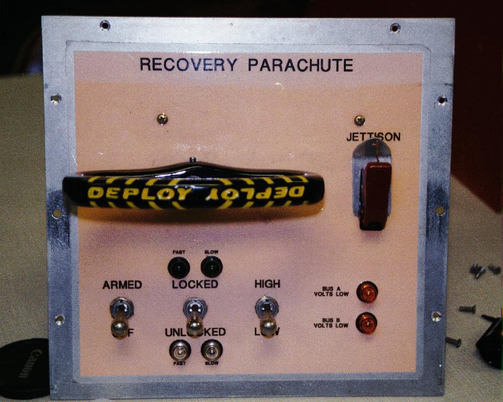

As others have noted, interlocking paired systems
as a hedge against 'accidental' switch positioning
does not yield the best FEMA and probability for
success in all foreseeable failures. In 45 years
of slinging wire in systems on ultra-lights to Hawker
4000, I have used only ONE compliment of lever-lock
and covered switches on 4 installations . . .
[img]cid:.0[/img]
This was done on a system that blew the A## end of the airplane off
and threw out a parachute that made the airplane very difficult to fly
while offering a way to recover an un-flyable airplane.
In this case, lever-locks and covers had nothing to do with
prevention of accidental motion and everything to do with
encouraging focused attention on the action for the purpose
of mitigating an exceedingly stressful flight condition.

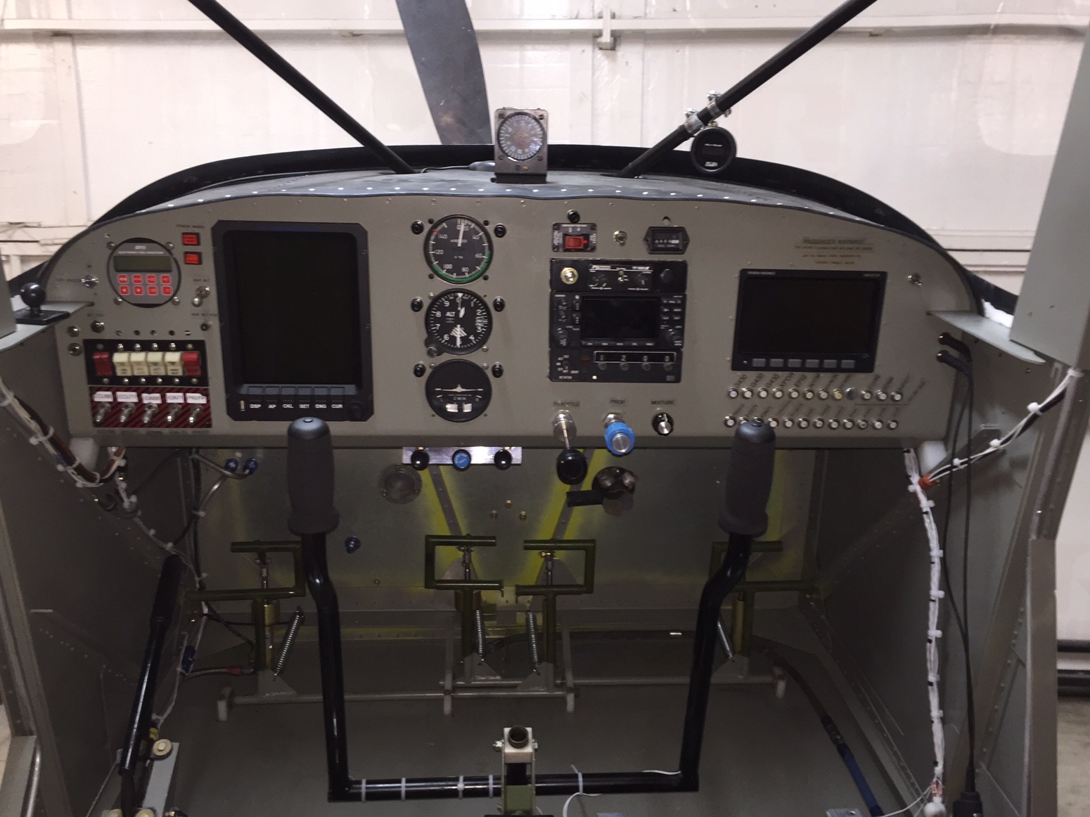

One of the most exciting parts of the build, for me, was the human factors engineering. Switch layout, type of switches, safety concerns with an electric dependent engine, and how pilots will interact with the system. Below is a picture of my final product.
As I mentioned before, all switches critical to the engine running are milspec lever-lock switches. I can't count the times during turbulence that I've reached for something on the panel and touched something else due to bouncing around. I don't to accidentally bump an engine switch off during flight due to turbulence (although any single switch would not shut it down. It would take the correct pair). It was an easy solution that I like, and I wouldn't change a thing.

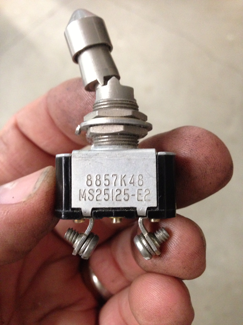

There are good quality switches that have a locking feature that will lock the switch in either position. To change the switches position you have to pull the switch bat out to release the movement to change it's position. I have used these in places where I never want the switch to be moved accidentally. I've found them at Digikey. Here's an example:  http://www.digikey.com/product-detail/en/apem-inc/631H%2F22V/679-1212-ND/1280278
These don't use a switch cover to protect against accidental actuation, the protection is built into the mechanical design of the switch. A similar feature can be found in switches of various mounting styles, pole configurations and capacities.
Bill Putney - N5413K

I would not want a guard that hides the switch position. If a guard is closed I want it to be confirmation of the switch position. Most aviation guards do that and further they suggest that the switch is important enough to not touch without thinking about it a moment. Too many guarded switches actually destroys that little bit of psychological protection.\
 Most off-the-shelf switch covers will force the
 switch to one side when closed. Operating the switch
 requires that the cover be opened before the switch
 can be moved . . . and the cover must remain open.
 Closing the cover forces the switch back.
 You have to work pretty hard to find covers that
 allow 'protection' in either switch position.

You have to look no further than 'Steinair' for a selection of locking switches:
http://www.steinair.com/store.cfm?tlcatid=23
Regards:
John

There are good quality switches that have a locking feature that will lock the switch in either position. To change the switches position you have to pull the switch bat out to release the movement to change it's position. I have used these in places where I never want the switch to be moved accidentally. I've found them at Digikey. Here's an example: [/url][url=http://www.digikey.com/product-detail/en/apem-inc/631H%2F22V/679-1212-ND/1280278]http://www.digikey.com/product-detail/en/apem-inc/631H%2F22V/679-1212-ND/1280278
