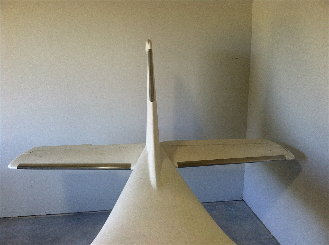

OC,  Here's the stainless leading edges on the tail feathers.The wings will have the same.
I decided to do this because I wanted a different look from the usual white plane with wavy colored lines.
The useful attribute is protection from dings by kicked up pebbles, etc.
Al

That looks good and sounds like a great way to protect the leading edges. Where did you get the SS?

PostPosted: Sun Apr 24, 2016 11:43 am    Post subject: Another Cruiser first. Reply with quote
Got the SS online from a manufacturer of sheet steel. It was a 50' roll of 8"cut off. A bitch to bend lengthwise even though it's thin stuff. Had to use two angle irons - one on each side - and squeeze together with pipe clamps. I laid a pipe on the SS to help control the shape of the bend.

That sounds like a lot of work but may be worth the effort if you ever encounter a bird strike.

Another option to get a similar look is stainless steel foil tape:
http://www.ebay.com/itm/15D571-Foil-Tape-3-In-x-3-Yd-Stainless-Steel-/221574057967
I am sure it is not as much protection but it is lighter and more simple to do.
Now put this under it for deicing...
http://www.ebay.com/itm/Flex-Watt-Heat-Tape-Reptile-Pet-Terrarium-Cage-Egg-Incubator-Heater-Warmer-/230921106672

PostPosted: Tue Apr 26, 2016 9:20 am    Post subject: Another Cruiser first. Reply with quote
Except, if you do nod blend it perfectly with the rest of the airfoil, for sure it would destroy the laminar flow.That converts into loosing speed....

Perfect laminar flow does not exist in nature or aircraft .

I can speak from experience that a dead on bird strike to the leading edge of the wing does in fact destroy the laminar flow along with clean underwear.  It totally flattened the outer most 3 feet of a Cessna 172 wing.

PostPosted: Wed Apr 27, 2016 7:14 am    Post subject: Another Cruiser first. Reply with quote
All decent  airfoils have laminar flow at the front part, from the nose to the thickest part of the wing.The nose of the airfoil is the most sensitive part and any disturbance there results in turbulent flow.Ask glider pilots. They will tell you that bugs smashed on the front of the wing can significantly reduce  performance of the glider.Supposedly even a color strip painted along the nose of the wing is no good.

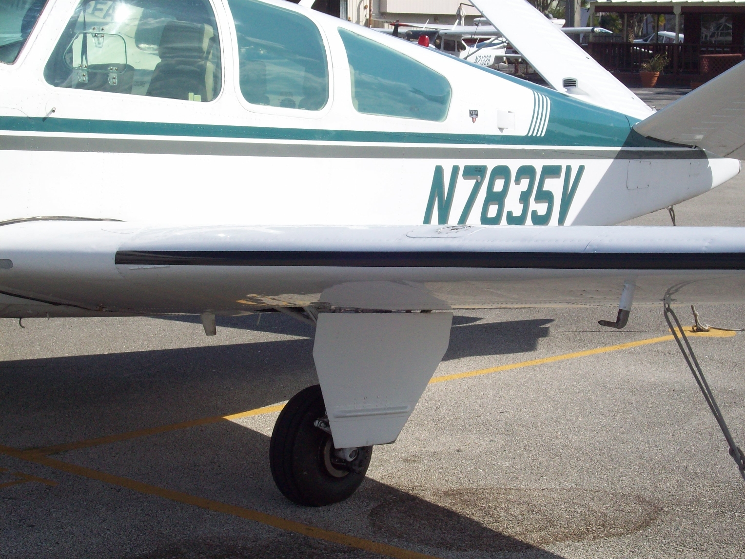

PostPosted: Wed Apr 27, 2016 11:40 am    Post subject: Another Cruiser first. Reply with quote
Many certified planes have tape or de-ice boots on their leading edges. I never heard of losing speed being a concern.

PostPosted: Wed Apr 27, 2016 1:23 pm    Post subject: Another Cruiser first. Reply with quote
Actually loss of speed is one of the big issues with de-ice boots and there have been many studies of this. Most modern jets use heat on the leading edge instead of boots for this reason along with others.
Real life laminar flow does commonly happen. Even in the slip stream of the prop. The whole idea of a laminar flow airfoil is to extend the amount of laminar flow farther than a conventional airfoil. Even a conventional airfoil has some laminar flow and to 25% cord or more is typical.
But for many KIS owner/builders the speed is not the end goal and this should not be large. For others speed is more of the goal. To each their own and that is why we all end up with different aircraft even when we started with the same kit.
