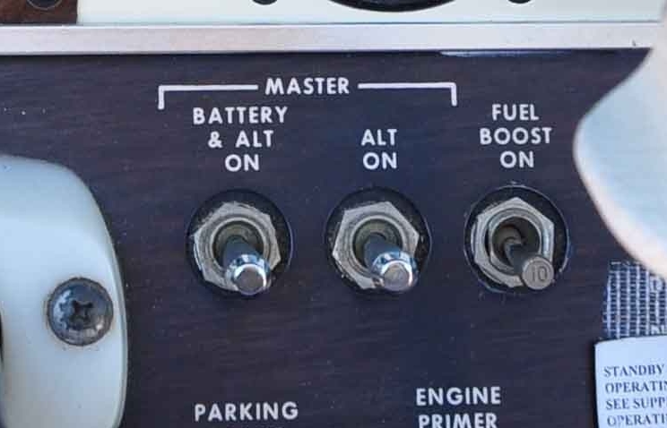

The earliest alternators on Cessnas (and indeed
all other S.E. TC aircraft) were automotive
derivatives. I was not privy to any investigative
tests at Cessna but the corporate policy was
that their airplanes should not be operated
sans battery. Hence, the split rocker switch
was birthed.
Apparently, Beech experience was different. While
many if not most of the smaller S.E. aircraft
did the same battery-first-then-alternator
switching protocol. Re: B-23 Sundowner panel
excerpt below . . .
[img]cid:.0[/img]
The Bonanza and Barons were different. The first
regulator design I qualified for Beech was about 1978 and
their procurement specification stated that no feature
of the regulator's circuitry 'shall prevent the alternator
from coming up self-excited above xxxx rpm". This was
the first time I'd encountered an alternator EXPECTED to
come up all by itself. The Bonanza and Barons had totally
independent battery and alternator switches. Operation
sans battery was not prohibited and in fact the system
was designed to allow it.
