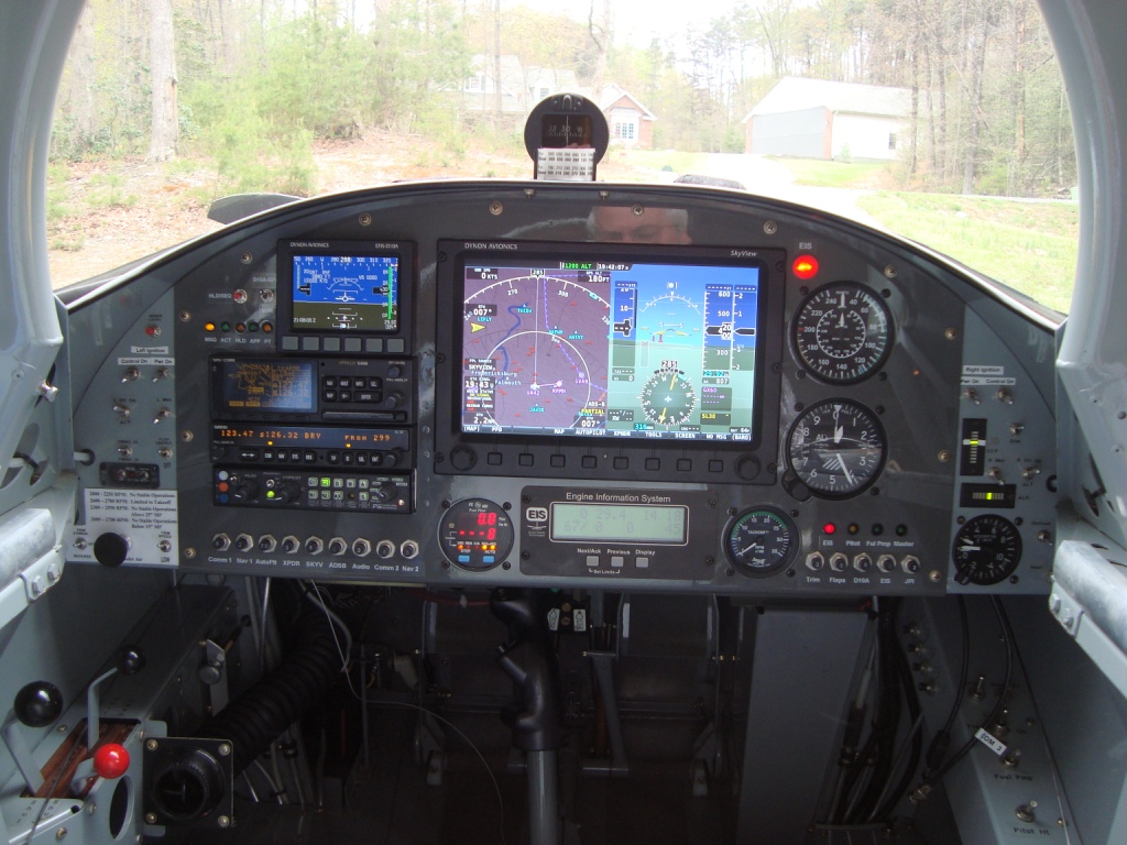

PostPosted: Tue Jul 19, 2016 9:30 am    Post subject: HSI repair vs new EFIS Reply with quote
If you want to just fix the HSI issue replace it with a Dynon D10A (~$2200).
If at some point you upgrade the rest of the panel with AFS, SkyView or whatever the D10A then serves as a standalone backup. Attached photo is an RV-8A panel upgrade to a single 10" SkyView EFIS while retaining the original GRT EIS, JPI Fuel Flow, D10A and a few steam gauges. The upgrade also included both roll and pitch Dynon autopilot servos and AOA heated pitot.
