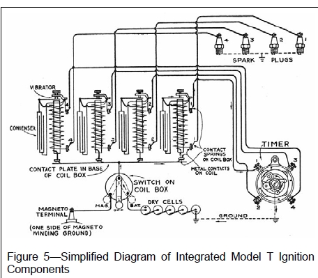

Interestingly enough, the model T engine was
wwaayyyy ahead of its time. Like modern automobiles,
each spark plug enjoyed its own, dedicated ignition
coil.
This offered some level of failure tolerance
for the coils each of which behaved much like the
'shower of sparks' system and featured its
own set of vibrator points and 'condenser'.
[img]cid:.0[/img]
The fundamentals for storing energy on an
inductor, using 'transformer action' of a
high ratio secondary, periodic charging
and release of the energy through a switch
and value of adding a capacitor across that
switch to improve spark performance and
switch life were well understood. The Ford
system described above illustrates application
of those principals.
