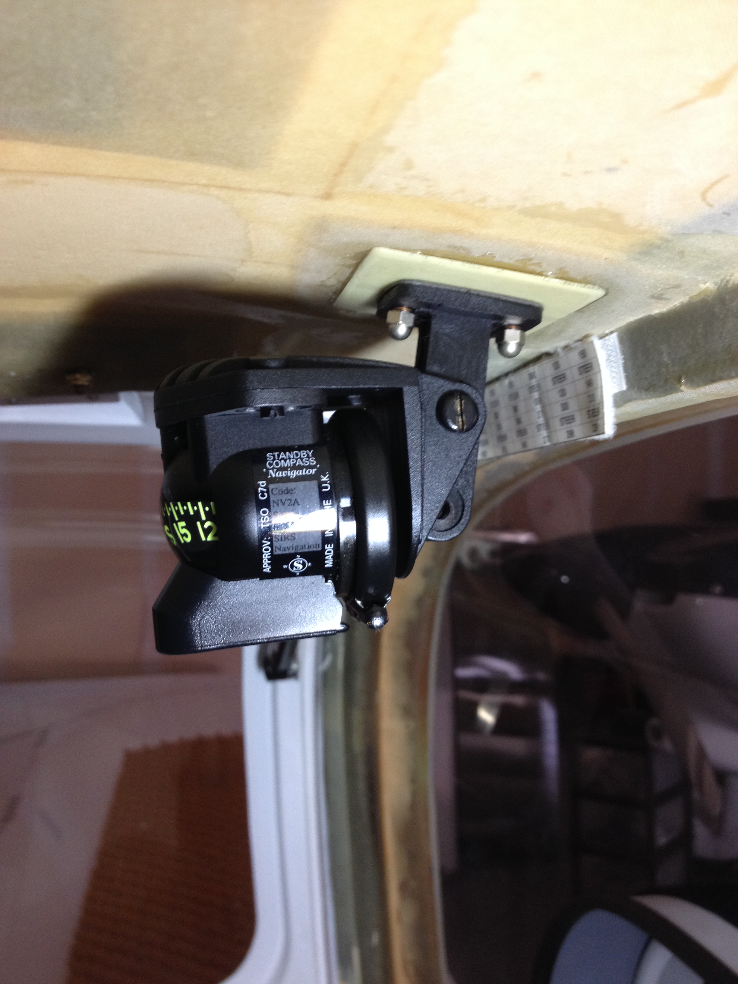

Hello Steve, Attached is the picture of my KIS TR-1 magnetic compass
mounting that I promised to send to you.
As you can see it is mounted onto the fuselage ceiling just aft of the
windshield canopy / roll over support bow. This is a better location than
having the compass near any avionics and gyro instruments that can generate
a lot of magnetic influence trash.
The mounting method was to epoxy a small flat piece of fiberglass to the
ceiling with two small brass or aluminum (non magnetic) machine screws,
compatibly located, and projecting down into the compass mount. The screw
heads were fixed so that they would not rotate and the compass mount was
then held in position by two non magnetic cap or acorn nuts.
Any questions?
OC
PS: Note the compass correction card fastened to the canopy bow.

Thanks!!! Mine is a Vertical Card Compass... That looks great!
