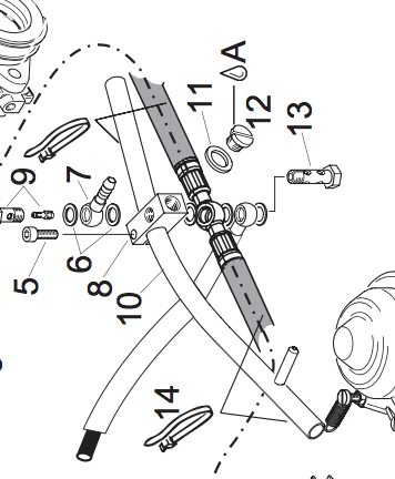

I am replacing the rubber fuel lines on my Rotax 912 UL engine. There is a five barb aluminum fuel line distributor on top of the engine. Two of the barbed connectors on this fuel distributor have flow restrictors in them. One of the two barb connectors with restrictors has a small crack in it. I need to replace the entire distributor. Where can I find this aluminum fuel distributor?

Hugh, you may be referring to this assembly, depicted on page 21-2 of the Illustrated Parts Catalog, May 01/2009 (may be on a different page in other editions):
[img]cid:part1.8727F9DC.5F49E8C5(at)AbstractConcreteWorks.com[/img]
You should be able to buy all of the parts from Lockwood Aviation, of Sebring FL:  https://lockwood.aero/
