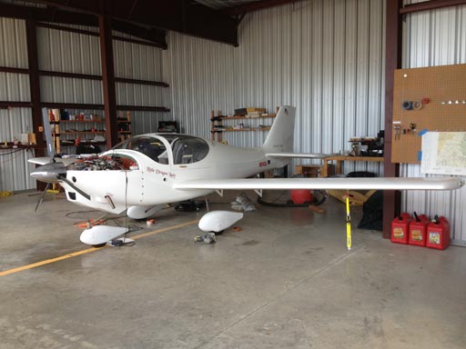

rlborger(at)mac.com
PostPosted: Sun Jan 15, 2017 2:40 pm    Post subject: Coolant Hose Reply with quote
Hugh,
I purchased the hoses from Stefan Ingemarsson (ingemarsson(at)gmail.com (ingemarsson(at)gmail.com)). The set he sells is specific to the Europa Classic or XS.
The Europa is a tractor, cowled installation.
[img]cid:DA64CF7C-8B90-40F0-9225-B0F3AFF58B4E[/img]
The radiator is located below the engine.
