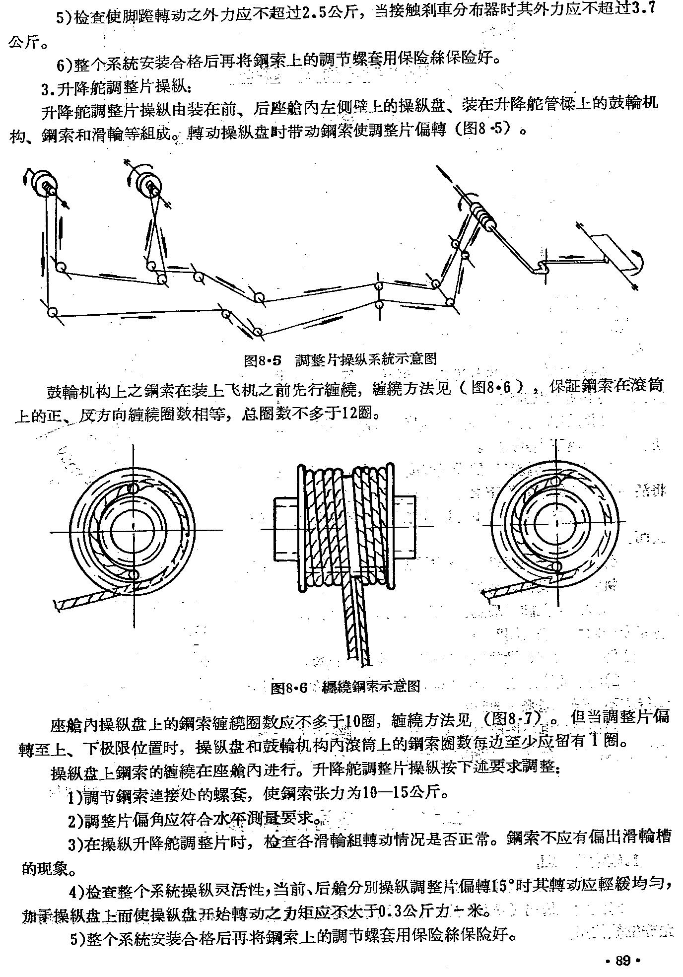

Set the trim in neutral (tab lined up with elevator), solder ball onto cable where the micro switch is (mark it first, then move it to a place you have access)
