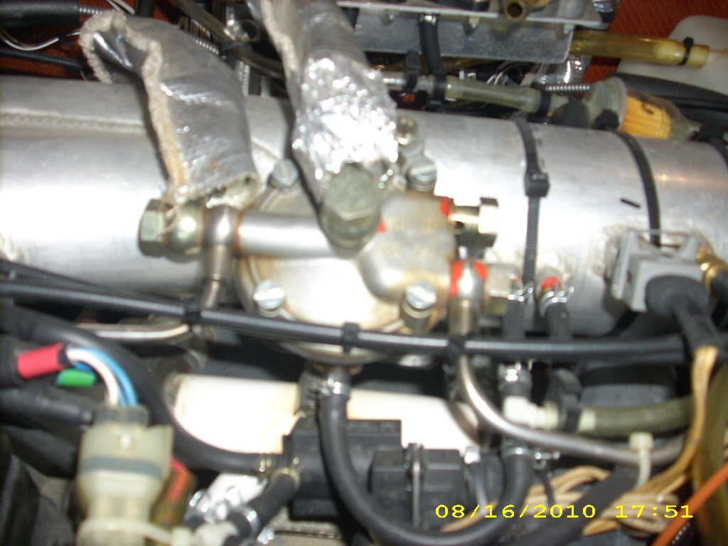

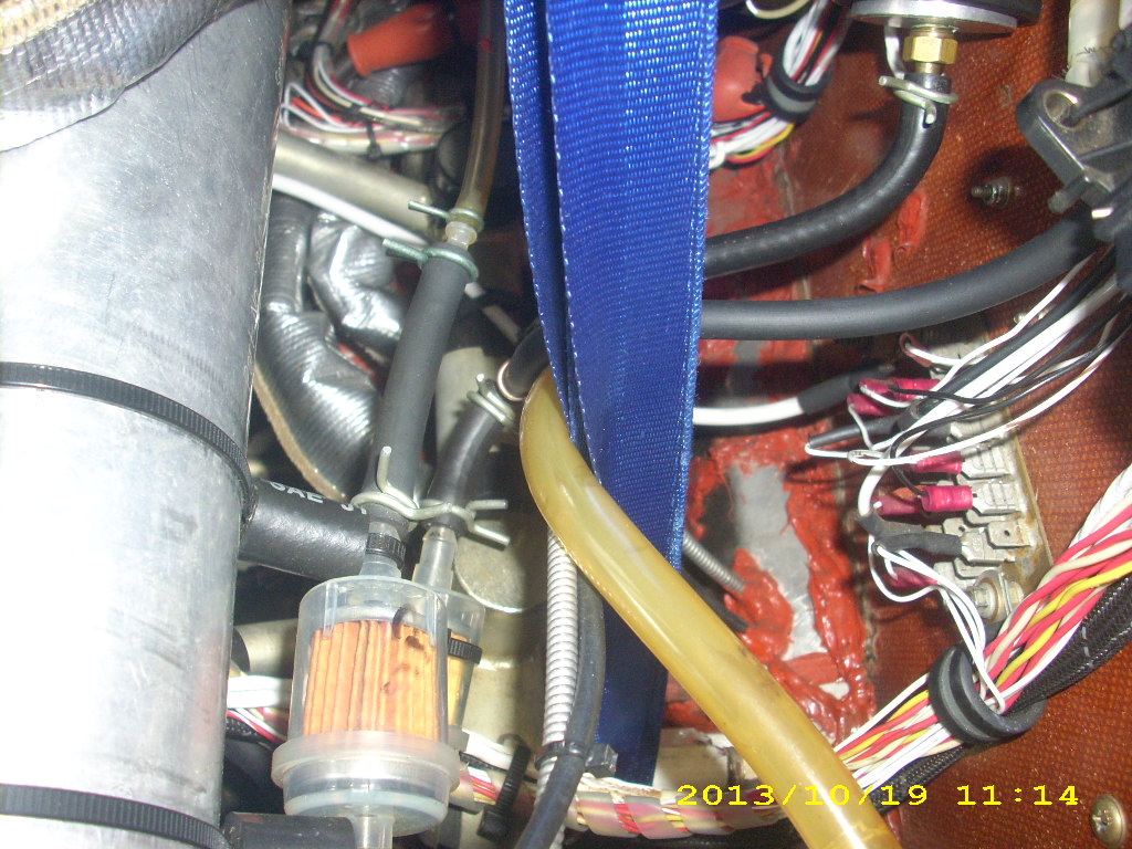

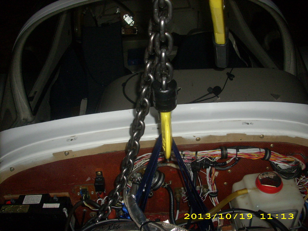

PostPosted: Sat Feb 11, 2017 9:05 am    Post subject: Re: 914 air box pressure sensor Reply with quote
Hi Frank,
Well, here are a few photos. Funny how you never seem to have just the correct one!
Hope these help. If you need more, let us know and we can take more photos.
Jim

shows sensors to right of strap. Fuel press sensor to left of yellow hook.

shows airbox sensor to right. also bottom of fuel press sensor. Also the water filters.

looking toward firewall. You can see air box press tee pointing to right. Also can see extra fuel hose going to diff fuel press sensot.
