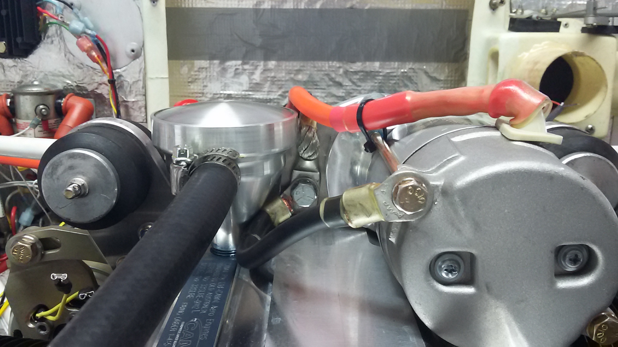

PostPosted: Mon Feb 13, 2017 10:48 pm    Post subject: Starter issue with 2200 Reply with quote
Hi Frank,
The silver body starter will help, it's a lot more powerful. But only if you get the electric current to the starter with minimal losses. So that strap will help, it reduces electrical resistance from battery to the starter. All other connections need to be good as well, so check that your ground path is good, and that your starter relay is in good condition.
Other things to look at: A battery with low internal resistance. Not all battery's are made equal. For me a LiFePO4 (EarthX or similar) made a huge difference, and shaved 5 kg off the weight of the plane.
Hope this helps,
Rob

 Filesize:  677.47 KB
 Viewed:  10836 Time(s)
