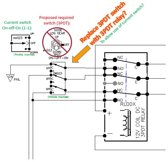

I'm hoping to get some help in swapping out a 3PDT switch with a 3PDT relay.
Here's the background: I'm building a Long-EZ and there is a promising new electrical scheme to drive the electrical nose gear actuator in canards. This new wiring calls for replacing the old SPST (1-1, ON-OFF-ON) Nose Gear Up/Down switch with a 3PDT ON-OFF-ON switch.
The problem for me is that I already have my current nose gear switch nicely configured and installed in my throttle handle, and I really, really don't want to swap it out. So, I was thinking I could swap out the newly required 3PDT switch with a 3PDT relay.
However, with this being the gear switch, in my mind there's a problem in doing this since there's that pesky "-OFF-" position on the switch, that to my knowledge doesn't translate over to a "middle position" between N.O. and N.C. on a relay. As you probably know, on canards we don't simply use a binary, all-the-way up or down gear position (only for TO/landing ops), but use the gear switch to position the nose in a myriad of heights off the ground when parked. Thus I need to be able to hit the nose gear up/down position, have it run down for a few seconds and then move the switch to the "OFF" position to stop the gear from moving any forward.
I've attached a diagram to show what I'm talking about. Any help would be greatly appreciated.

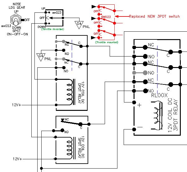

How about 2 separate 3 pole relays? Both off with switch in center, one
or the other active with switch up or down.

Ok, I think I see how that would work to solve the center "off" dilemma. Now, would it be more advisable to use two 3PST relays? Or does it matter at all?

I'm pretty sure I got it! Thanks CE, you definitely got me thinking in the right direction.
Because the new required 3PDT switch had 2 poles in one direction and one in the other I was able to pare down the two 3PDT relays into a DPDT and an SPDT relay set.
Attached is a diagram showing the implementation of these relays to allow me to continue to use my SPST (1-1) ON-OFF-ON landing gear up/down switch as per my original design.

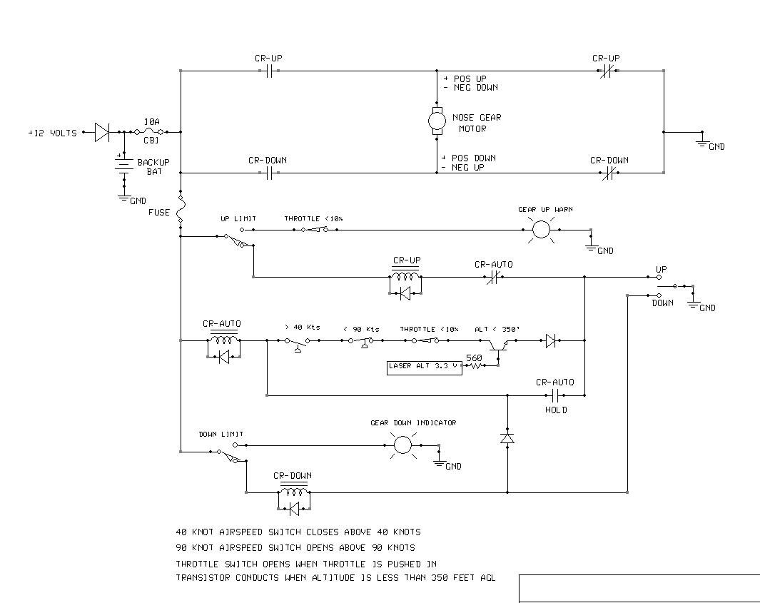

I've attached the entire schematic here for clarity. I was reluctant to add all of it earlier since this is the result of Marc Zeitlin's work over the past year to improve the canard electric nose gear system. This modified system shown is specifically Jack Wilhelmson's from eznoselift.com.
In the diagram, everything to the right of the P1 connector is Jack's original system. Everything to the left (virtually all of it) is Marc's new system. The one issue I've been asking about on the Cozy forum is how to tie back in the backup battery (in red, lower right corner) that was/is a part of Jack's original system, but left out of Marc's new variant since Marc has a mechanical means of lowering the gear in case of an electrical failure.
This diagram is my latest version, showing my swapping out the required 3PDT gear up/down switch with the DPDT and SPDT relays to allow me to use my original SPST switch.

There are 3 diodes in your drawing that appear to have their anodes connected together, even though there is no dot. Are they supposed to be connected? If so, how can current flow through back to back diodes? I understand that the diode pointing up is for arc suppression.
How can the AUTO relay be energized when the negative side of its coil is connected to ground through its own normally open contacts?
What am I missing?

PostPosted: Tue Feb 28, 2017 8:36 am    Post subject: Re: 3PDT switch swap for relay? Reply with quote
Never mind. I realize that is a holding circuit as long as the switch is in the UP position. But there is a connecting dot missing, right?

PostPosted: Wed Mar 01, 2017 8:09 am    Post subject: Re: 3PDT switch swap for relay? Reply with quote
Joe,
Yes, that connecting dot is missing!
That's how it was in the original diagram that I copied, and I spent quite a while trying to figure it out! I actually figured it out --with copious amounts of head scratching-- after I posted this latest diagram. I'm no electronics guru, but I had never seen diodes configured like that before on a diagram.
As you may have noted, that relay (which has the 3 diodes treed off of it) is the heart of the auto gear extend feature and the its coil will not get powered unless EVERY parameter required occurs (throttle less than 10 percent and airspeed between 40 knots & 90 knots) with the transistor opening to ground by the laser altimeter when it reaches <= 350 ft AGL. It's pretty slick once you see what it's actually doing.

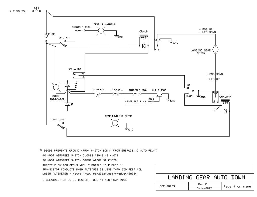

Cozy Nose Gear circuit is attached. I do not have a Cozy.
If switch is in "UP" position and airspeed is greater than 40 and less than 90 and if throttle is closed and if altitude is less than 350 feet, then "AUTO" relay will energize and hold. The "UP" relay will drop out (if it was energized). The "DOWN" relay will energize. The "AUTO" relay will remain energized and holding until the switch is moved to the center, off, position or moved to the down position. "Auto down" is disabled when switch is off.
Comments and criticism welcome.

I converted the schematic diagram into a wiring diagram.

Joe Gores
ranchlaseigneurie(at)hotm
PostPosted: Tue Mar 14, 2017 10:19 am    Post subject: 3PDT switch swap for relay? Reply with quote
Hello
Can it be use for landing on glassy water....for float plane..
Thanks for your time
Gilles
From: owner-aeroelectric-list-server(at)matronics.com <owner-aeroelectric-list-server(at)matronics.com> on behalf of user9253 <fransew(at)gmail.com>
Sent: March 14, 2017 11:38:10 AM
Subject: Re: 3PDT switch swap for relay?
Laser altimeter - https://www.parallax.com/product/28054
Joe Gores
http://forums.matronics.com/viewtopic.php?p=467291#467291
http://forums.matronics.com//files/landing_gear_joe_7_202.jpg
http://forums.matronics.com//files/landing_gear_joe_7_195.pdf
Gee, I do not know. Try calling the laser altimeter manufacturer. I have never used their product. I just drew the diagram for Wade, the original poster of this thread. I assume that you only want the altimeter feature and not the gear extend.

PostPosted: Wed Mar 15, 2017 4:12 am    Post subject: Re: 3PDT switch swap for relay? Reply with quote
From what I understand it's SUPPOSED to provide a good reading over water, but hasn't been specifically tested yet for that functionality. Some of the canard folks were asking the same question.
In short, specs say yes, but hasn't been tested on an actual flying canard that I know of.
Joe, thanks a million for your diagrams and great advice! All of it is super helpful!
