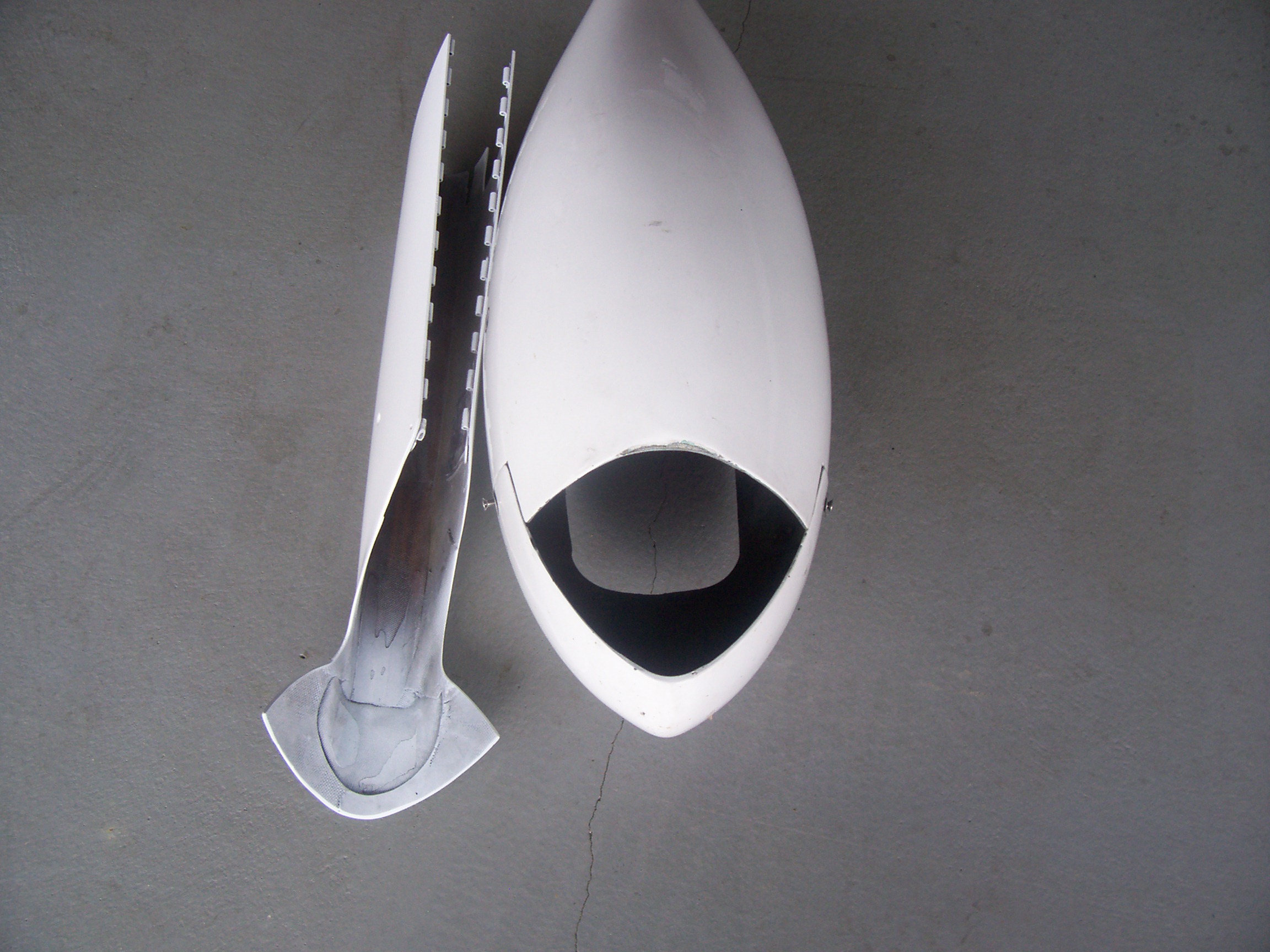

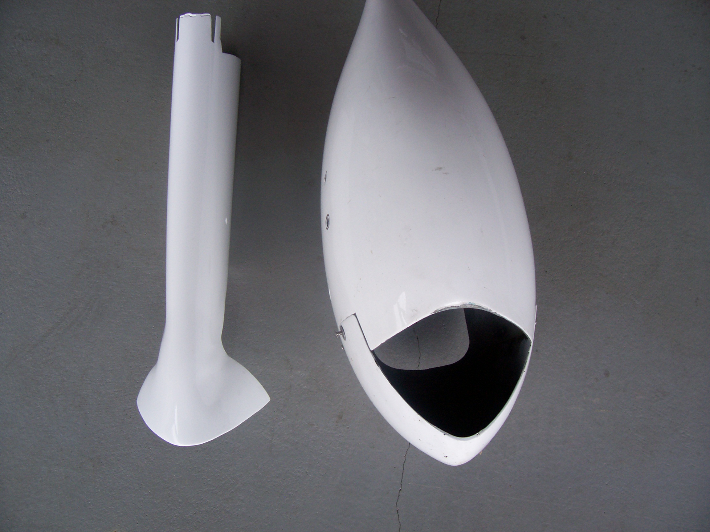

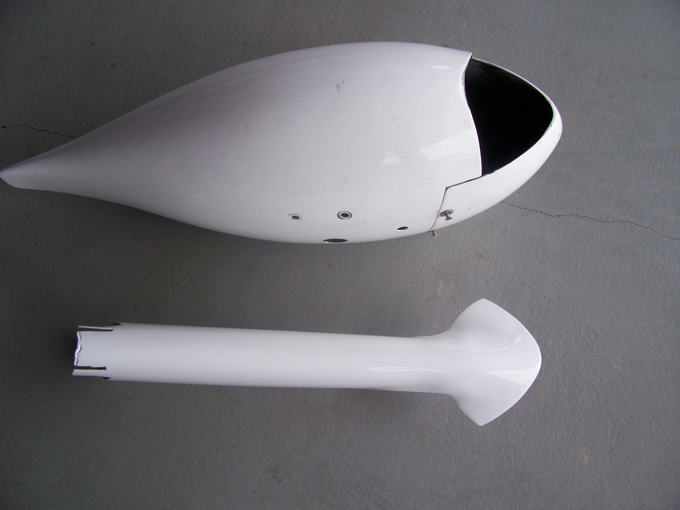

Hello Steve, Here are some of the pictures that I have been promising you:
0132: This is a photo of both the nose gear leg fairing (on the left) and
the wheel pant (on the right). The leg fairing was made from a Glastar /
Sportsman nose gear leg fairing. It was assembled from two pieces (a left
and a right). The top was cut off and the bottom modified to fit the opening
in the nose wheel pant. The nose wheel pant came from Van's.
0133: Just another view of the same two items in 0132 described above.
0134: This view shows how the trailing edge of the leg fairing is held
together with hinge material and a hinge pin.
Any questions?
