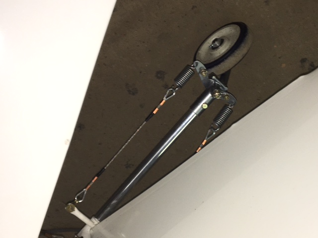

PostPosted: Sat Apr 08, 2017 7:19 pm    Post subject: Blue Bird Flight Reply with quote
John, it's good to hear you're up there having some fun. I finished the new breakaway tailwheel project today. Now I just need some warm weather up here in northern Michigan so I can finish painting the left wing on the old Firestar MK1, so I can try it out.

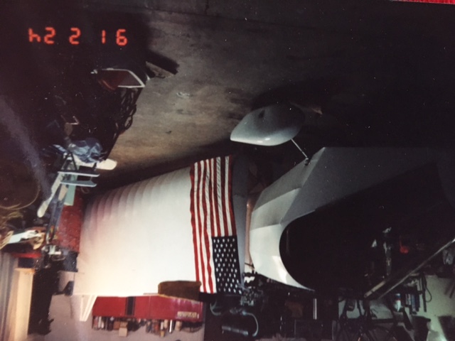

PostPosted: Sat Apr 08, 2017 9:05 pm    Post subject: Blue Bird Flight Reply with quote
You're right, John. Original is just to much typing every time. I'll just use Firestar 1 in the future. I did build a Twinstar Mk II which was the second variant of original Twinstar. (open to enclosed cockpit)Which lead to the original MkIII.

Don't think there was a MKI, but I know what you are getting at. Folks, not Homer Kolb, decided to call the first FS model the "original" FS, and the "original" MKIII.
BTW: You could cut that tail wheel strut in half and still have more strut than you will ever need. Shortening the strut reduces torsional twist, bouncing, bending, and wiggling. Makes tail wheel steering a little tighter. I use a 6" (exposed length) .120" wall heat treated 4130 strut. Works good on Miss P'fer.

PostPosted: Sun Apr 09, 2017 12:47 pm    Post subject: Blue Bird Flight Reply with quote
John, I meant to thank you for tailwheel strut info. Makes sense to me. I'll give shortening it up a bit a try. I just left the length the same as the original fiberglass strut.

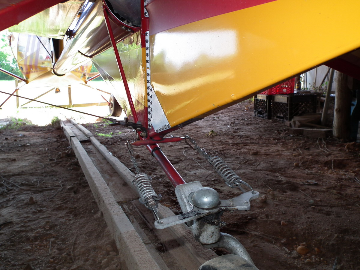

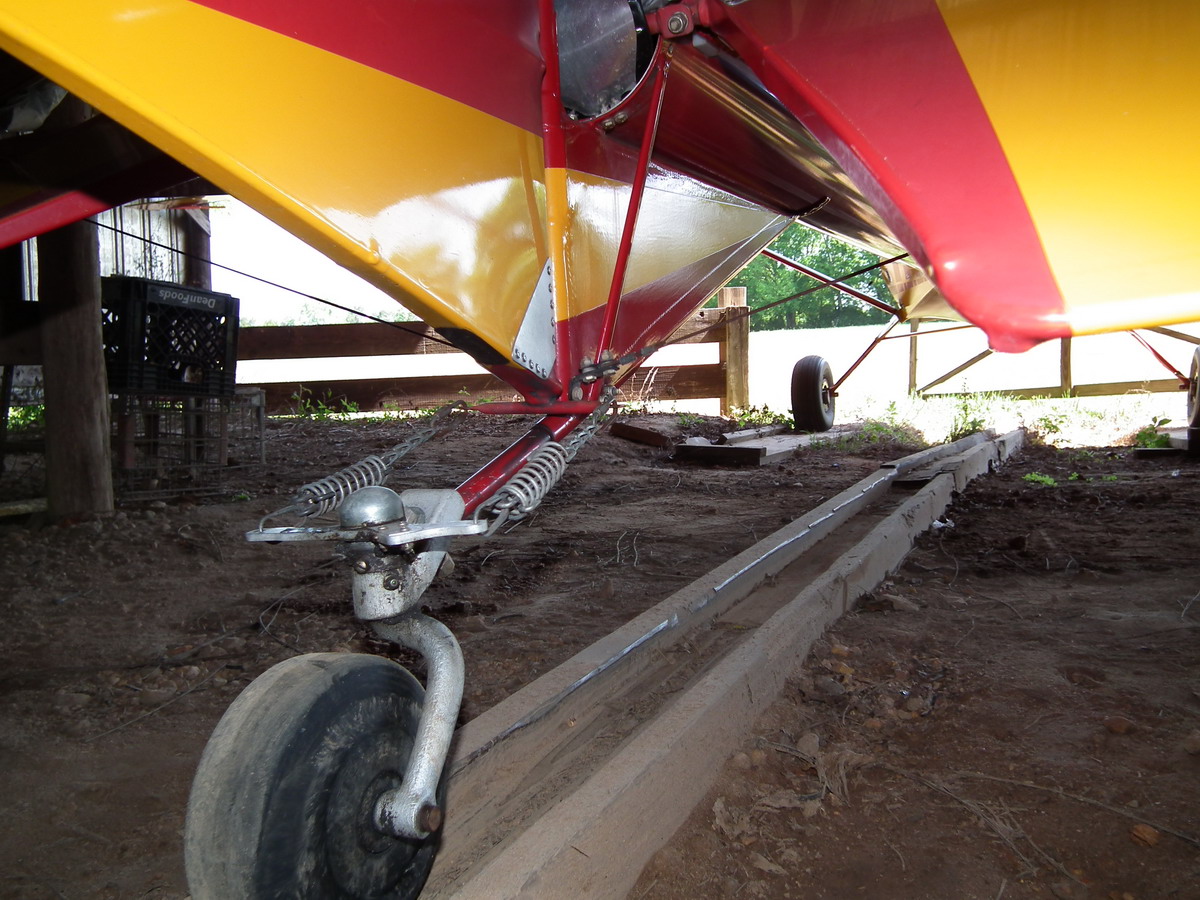

PostPosted: Sun Apr 09, 2017 2:27 pm    Post subject: Blue Bird Flight Reply with quote
George H/Kolbers:
The two photos will give you an idea what mine looks like.
