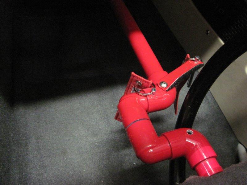

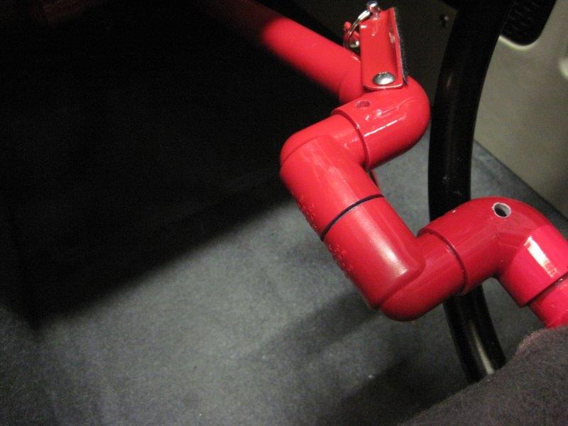

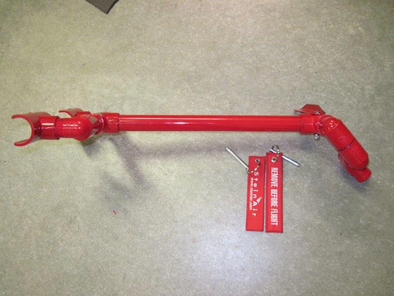

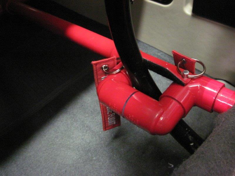

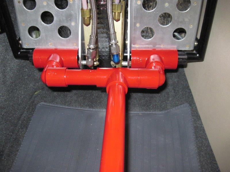

PostPosted: Thu Aug 10, 2017 6:05 am    Post subject: Re: Gust Lock Reviews Reply with quote

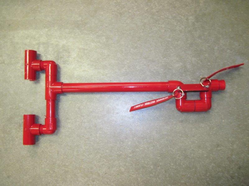

I made this out of PVC. 600 hours and still working well

Bill,
That's very similar to what I was thinking of making. Does it hold the stick well in roll also?

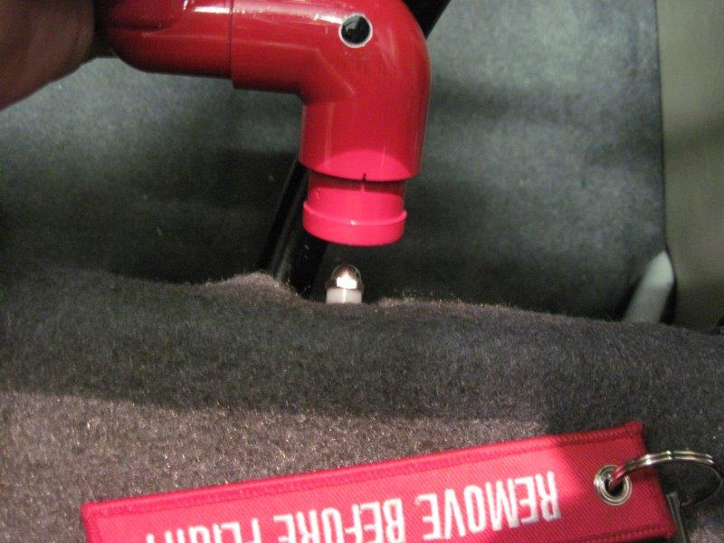

PostPosted: Thu Aug 10, 2017 7:02 am    Post subject: Re: Gust Lock Reviews Reply with quote
Yes, it holds the stick and the rudder pedals. I have a #8 screw with a castellated nut that protrudes through the front web that secures the end of the gust lock from lateral movement. You can see it in the photos. Total cost under $10.

I built the PVC gust lock and have been happy with the results as well. Mine looks exactly like the one above, except it doesn't lock the stick. It just goes straight back and wedges on the back wall of the foot well. I use the seat belt for the stick.

PostPosted: Thu Aug 10, 2017 9:19 am    Post subject: Gust Lock Reviews Reply with quote
I 'll second Bill's comments wrt the gust lick.
Works very well
Rick
