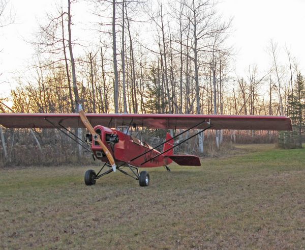

PostPosted: Fri Apr 28, 2017 4:04 pm    Post subject: Re: Cont. 0200 prop pitch Reply with quote
I recently replaced the Continental A75 on my Pietenpol with
an 0200-A.
We used the Cloudcars 74-38 that was on the A75 after counterboring
the holes to fit the 0200-A.
It looks large in the photo but there is 9" clearance !!
Full throttle static rpm was 2500 and the first 2 test flights showed
normal operating rpms .
Patricia

pjb
Joined: 30 Jul 2014
Posts: 19
PostPosted: Thu Sep 14, 2017 10:25 am    Post subject: Re: Cont. 0200 prop pitch Reply with quote
an 0200-A.
Patricia
I spoke too soon !!
We have flown about 7 hours since installing the 0 SMOH 0-200A engine
on my Pietenpol so I now have a better idea of the performance as the
engine 'loosens up'
The 74-38 prop is way too fine a pitch and the engine needs to be throttled
back to prevent overspeeding. The result is that we're not able to use the
full power of the engine and we're not getting either good climb or good
cruise.
A few days ago, I tried a borrowed 72-40 prop and it was considerably
better [ did not overspeed on climb out but did overspeed in cruise.
I think we still need a slightly coarser pitch and will be trying out
another borrowed prop this week.
When I have a good idea of the numbers, I will buy one. I still want a wood
prop.
Has anyone had a similar experience matching a wood prop to the 0-200A
engine on a Piet ?
Patricia
> an 0200-A.
> Patricia
I spoke too soon !!
engine 'loosens up'
The 74-38 prop is way too fine a pitch and the engine needs to be throttled back to prevent overspeeding. The result is that we're not able to use the
cruise.
prop.
engine on a Piet ?
Patricia

Hi Ron,
That's very nice of you to let me try your 71-46 but I think it
would be a little too coarse a pitch.
So far I've tried:
The original wood 74-38 which was way too fine. Overspeeded on take-off
and in level flight.
A wood 72-40 which produced full throttle static rpm of 2625
[ we also flight tested this one and it overspeeded in level flight but not on take-off.
A metal 73-45 which produced full throttle static rpm of 2375
[ we didn't flight test this one]
Yes, CGV2 is near me.
Cheers,
Patricia
